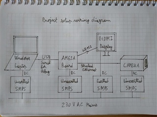

    Can I also confirm the Block diagram of your setup?
    SK-AM62A-LP <-> DP83867 <-RJ-45 to CAT5e M12-D Cable-> Camera
    Alvaro
  • Hi Alvaro,
    I checked the Link Quality Registers and they're all over the place.
    I setup the registers to access channel A's Link Quality register, then read this register automatically every 0.5 seconds with the following commands:
    phytool write eth0/0x0/0x0D 0x001F
    phytool write eth0/0x0/0x0E 0x0225
    phytool write eth0/0x0/0x0D 0x401F
    phytool read eth0/0x0/0x0E
    while true; do phytool read eth0/0x0/0x0E; sleep 0.5; done
    You can find the Link quality log in the "Link quality log.txt" file:

    Your Block diagram of my setup is right. The DP83867 is on the SK-AM62A-LP board.
    Thomas
  • Hi Thomas,
    Thank you again for the detailed reply (especially the graphs).
    Channel B-D reading 0x7FFF is expected when linked up in 100 Mbps (when linked at gigabit, all registers give MSE values).
    In your PHY register log, you initially have the camera disconnected and print register 0x0-1F, then connect the camera afterwards.
    Kernel message says link is up - 100 Mbps Full, but then another kernel message says link is down before you print the registers again (lines 38 -43).
    Register 0x01 in Line 44 says link is up, which contradicts the kernel message. Is this a consistent trend where the Kernel says link is down but the PHY is still showing link high (Register 0x1 & 0x11 can be used to check link)?
    I also noticed some RX Errors in Register 0x15, can we read extended Registers 0x2D, 0x6E & 0x6F? If both bits 14 & 3 of Reg 0x2D are both high this could be the reason for link down.
    Alvaro

  • Hi Alvaro,
    I'm back to work. I haven't conducted any further checks yet, but I suspect that the electrical noise may be originating from some switched-mode power supply (SMPS) in my setup.
    Here is a diagram of said setup if it can help :
    Thomas

  • Hi Thomas,
    Could you try setting Reg 0x1D5 = 0xF508? This increases the VOD swing on the MDI output.
    Alvaro
  • Hi Alvaro,
    Thank you for your suggestion. However, it does not appear to change the intermittent link disconnections.
    Regarding the power supplies, lithium batteries in series have been tested as a replacement to the camera's SMPS, yet the issue persists.
    Thomas
  • Hi Thomas,
    I'm afraid I don't have any more debug steps to take. The problem is specifically only with the camera correct? When eth0 is connected to any other device (pc, switch, etc) there is stable communication with no packet loss?
    Alvaro
  • Hi Alvaro,
    Yes there is stable communication with every other device. The problem has been experimented with two cameras of the same model.
    Thomas
  • Hi Thomas,
    Admittedly this is a hail Mary shot, but could you try replacing the current DP83867.c file included in the SDK with our most current one: https://github.com/TexasInstruments/ti-ethernet-software/tree/main/linux_drivers
    Within the SDK there should be a folder for the Linux Kernel, from this folder the ethernet drivers can be found in drivers/net/phy
    Keep a copy of the old driver and replace it with the new to see if anything changes (don't change the file names). You will have to run the make command again from the SDK_Install_Directory for the new driver to be built.
    Alvaro
