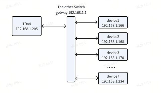

      Now we found phy error on our TDA4VM board. The log as follows:

The SDK: 08_06_00_12
The eth board: Refer to GESI
It is normal at the beginning and abnormal after running for a period of time. Can you give us some advice?
Zhang
    Can you please confirm, are you using the TI EVM? or custom Board?

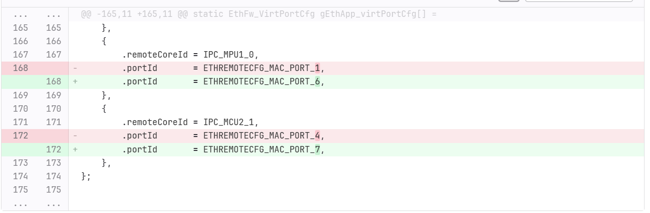

    If you made any changes on top of release ethfw, please share for review?
    Sudheer
  • Hi,Sudheer
         Thanks for your support.
         Yes, it's on our custom board. The PHY we used is the same as TDA4VM EVM. The log of MCU2_0 as follows:

       We have modify mac-only port from port1/4 to port port6/7.  That's the only change we made on the ethfw.  Changes on file as follows:
        board-support/linux-5.10.162+gitAUTOINC+76b3e88d56-g76b3e88d56/arch/arm64/boot/dts/ti/k3-j721e-common-proc-board.dts
    	cpsw9g_virt_maconly: main-r5fss-cpsw9g-virt-mac1 {
    	cpsw9g_virt_maconly: main-r5fss-cpsw9g-virt-mac6 {
    		compatible = "ti,j721e-cpsw-virt-mac";
    		dma-coherent;
    		ti,psil-base = <0x4a00>;
    		ti,remote-name = "mpu_1_0_ethmac-device-1";
    		ti,remote-name = "mpu_1_0_ethmac-device-6";
    		dmas = <&main_udmap 0xca00>,
    		       <&main_udmap 0xca01>,
    vision_apps/utils/ethfw/src/app_ethfw_freertos.c
    vision_apps/utils/ethfw/src/app_ethfw_tirtos.c
    vision_apps/utils/ethfw/src/concerto.mak
    Zhang
    From below EthFw log it seems like still Port-1 & Port-4 only configured as MAC only Ports.
    [MCU2_0] 13.844223 s: mpu_1_0 <-> MAC port 1: mpu_1_0_ethmac-device-1
    [MCU2_0] 13.844262 s: mcu_2_1 <-> MAC port 4: mcu_2_1_ethmac-device-4

  • Hi,Sudheer
        We got the LOG wrong before, the log of modified as follows:
    root@j7-evm:/opt/vision_apps# source ./vision_apps_init.sh
    root@j7-evm:/opt/vision_apps# [MCU2_0]      3.869061 s: CIO: Init ... Done !!!
    [MCU2_0]      3.869131 s: ### CPU Frequency = 1000000000 Hz
    [MCU2_0]      3.869173 s: CPU is running FreeRTOS
    [MCU2_0]      3.869197 s: APP: Init ... !!!
    [MCU2_0]      3.869219 s: SCICLIENT: Init ... !!!
    [MCU2_0]      3.869483 s: SCICLIENT: DMSC FW version [8.6.3--v08.06.03 (Chill Capybar]
    [MCU2_0]      3.869534 s: SCICLIENT: DMSC FW revision 0x8
    [MCU2_0]      3.869566 s: SCICLIENT: DMSC FW ABI revision 3.1
    [MCU2_0]      3.869602 s: SCICLIENT: Init ... Done !!!
    [MCU2_0]      3.869628 s: UDMA: Init ... !!!
    [MCU2_0]      3.871339 s: UDMA: Init ... Done !!!
    [MCU2_0]      3.871399 s: MEM: Init ... !!!
    [MCU2_0]      3.871440 s: MEM: Created heap (DDR_LOCAL_MEM, id=0, flags=0x00000004) @ d9000000 of size 16777216 bytes !!!
    [MCU2_0]      3.871516 s: MEM: Created heap (L3_MEM, id=1, flags=0x00000000) @ 3600000 of size 262144 bytes !!!
    [MCU2_0]      3.871577 s: MEM: Init ... Done !!!
    [MCU2_0]      3.871602 s: IPC: Init ... !!!
    [MCU2_0]      3.871662 s: IPC: 8 CPUs participating in IPC !!!
    [MCU2_0]      3.871710 s: IPC: Waiting for HLOS to be ready ... !!!
    [MCU2_0]     13.534331 s: IPC: HLOS is ready !!!
    [MCU2_0]     13.555524 s: IPC: Init ... Done !!!
    [MCU2_0]     13.555588 s: APP: Syncing with 7 CPUs ... !!!
    [MCU2_0]     14.227416 s: APP: Syncing with 7 CPUs ... Done !!!
    [MCU2_0]     14.227648 s: REMOTE_SERVICE: Init ... !!!
    [MCU2_0]     14.229365 s: REMOTE_SERVICE: Init ... Done !!!
    [MCU2_0]     14.229431 s: ETHFW: Init ... !!!
    [MCU2_0]     14.337461 s: Warning: Using 6 MAC address(es) from static pool
    [MCU2_0]     14.337573 s: ETHFW: Shared multicasts (software fanout):
    [MCU2_0]     14.337618 s: ETHFW: Reserved multicasts:
    [MCU2_0]     14.337645 s:   01:80:c2:00:00:0e
    [MCU2_0]     14.337690 s:   01:1b:19:00:00:00
    [MCU2_0]     14.337934 s: EnetMcm: CPSW_9G on MAIN NAVSS
    [MCU2_0]     14.345371 s: Mdio_open: MDIO manual mode enabled
    [MCU2_0]     14.348041 s: PHY 0 is alive
    [MCU2_0]     14.348330 s: PHY 3 is alive
    [MCU2_0]     14.348973 s: PHY 12 is alive
    [MCU2_0]     14.350655 s: EnetPhy_bindDriver: PHY 12: OUI:080028 Model:23 Ver:01 <-> 'dp83867' : OK
    [MCU2_0]     14.351161 s: EnetPhy_bindDriver: PHY 0: OUI:080028 Model:23 Ver:01 <-> 'dp83867' : OK
    [MCU2_0]     14.351640 s: EnetPhy_bindDriver: PHY 3: OUI:080028 Model:23 Ver:01 <-> 'dp83867' : OK
    [MCU2_0]     14.354204 s:
    [MCU2_0] ETHFW Version   : 0.02.00
    [MCU2_0]     14.354280 s: ETHFW Build Date: Jan  8, 2024
    [MCU2_0]     14.354314 s: ETHFW Build Time: 19:40:53
    [MCU2_0]     14.354340 s: ETHFW Commit SHA: 5994a127
    [MCU2_0]     14.354409 s: ETHFW: Init ... DONE !!!
    [MCU2_0]     14.354441 s: ETHFW: Remove server Init ... !!!
    [MCU2_0]     14.354622 s: CpswProxyServer: Virtual port configuration:
    [MCU2_0]     14.354673 s:   mpu_1_0 <-> Switch port 0: mpu_1_0_ethswitch-device-0
    [MCU2_0]     14.354716 s:   mcu_2_1 <-> Switch port 1: mcu_2_1_ethswitch-device-1
    [MCU2_0]     14.354756 s:   mpu_1_0 <-> MAC port 6: mpu_1_0_ethmac-device-6
    [MCU2_0]     14.354809 s:   mcu_2_1 <-> MAC port 7: mcu_2_1_ethmac-device-7
    [MCU2_0]     14.355844 s: CpswProxyServer: initialization completed (core: mcu2_0)
    [MCU2_0]     14.355911 s: ETHFW: Remove server Init ... DONE !!!
    [MCU2_0]     14.357092 s: Starting lwIP, local interface IP is dhcp-enabled
    [MCU2_0]     14.365248 s: Host MAC address: 70:ff:76:1d:92:c3
    [MCU2_0]     14.369500 s: [LWIPIF_LWIP] Enet LLD netif initialized successfully
    [MCU2_0]     14.369595 s: Added interface 'ti1', IP is 0.0.0.0

    Can you please share the changes you have made in EthFw for review?

         1. We refer to GESI board for hardware design, and don't make change on hardware. So this is four port on CPSW9G. The schematic diagram is as follows:

         3.On the basis of the above, we are using port3  to test our network service.Network structure is shown in figure:
           Can CPSW9G be used with the other switch?

    Now we found after we add application on MCU Domain the phy15 can't found and phy0 is not alive
    This could be due to pinmux conflict.
    Can you please share pinmux used in mcu application? Also co form phy0 connected on port-3 of cpsw9g?
    Yes, you can connect other switch to CPSW9G.
    Sudheer
        We found phy0 connected on port-8 of cpsw9g, phy15 connected on port-3 of cpsw9g. And we using port-3, the error occurs in PHY0.

       If we want to remove phy0 and phy15 from driver, what should we do?
    Zhang
       The file J721E_pinmux_data.c we used as follows:
    There is no pin config difference between Port-3, Port-8 (RGMII lines) & above PinMux.
    Can you please confirm Port-3 & Port-8 are in RGMII interface? If Port-8 is in RMII then it conflict with Mcasp configuration.
    Can also share the Pin Mux using for CPSW Ports?
    Disable the Ports connected with phy0 & phy15 from "gEthAppPorts" array in app_remoteswitchcfg_server/mcu2_0/main.c file and recompile the EthFw and use the updated binary.
    Bets Regards,
    Sudheer
