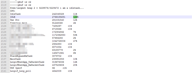

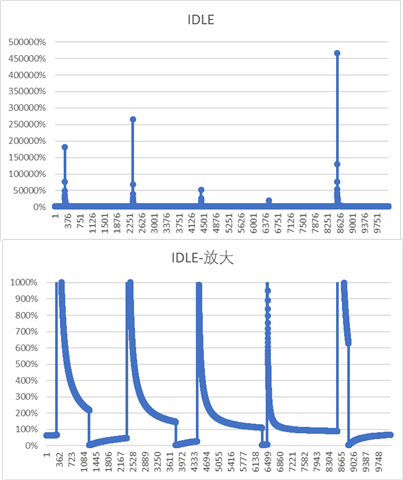

Call the vTaskGetRunTimeStats,after some time, it will exceed 100% CPU usage:
Below is IDLE task CPU usage every 2s.
Shine

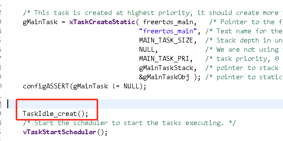

    void TaskIdle_creat()
        _TaskParams params;
        params.stackstr = NULL;
        params.stackSize = 4096;
        params.taskname = "Task_Idle";
        params.priority = 5;
        RTOS_TaskCreat(TaskIdle, &params, NULL);
    Customer added above function to main.c
    Then continue to observe more than 4h, save the printed data, after making the graph should be found
    Shine
