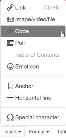

  • You can use the following reply feature to attach the logs
  • If I paste a too long text, it will reject with message:

    In your reply compose window, click "Insert" at the bottom of the window, then click "Image/Video/File", then in the new pop-up window, click the grey "Upload" right under the "File/URL" field, which should allow you to select the file and attach it.
  • Yes, I used this method before, but all can't access. Please wait me a while, I split it shorter and upload as several texts.
