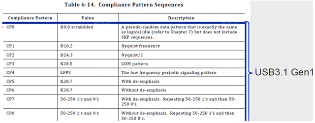

Also, we could not find the register address related to the CP0 & CP1 shown below in the USB3.0 compliance pattern sequence.

5: CP0 & CP1 Test (any command needed to switch from CP0 to CP1 test?)

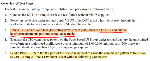

We have found some general test steps of USB3.0 standard shown below for CP0 & CP1 Test.
May I know is there a suggested configuration or command that could make TDA4VH enable USB3.0 Compliance mode?

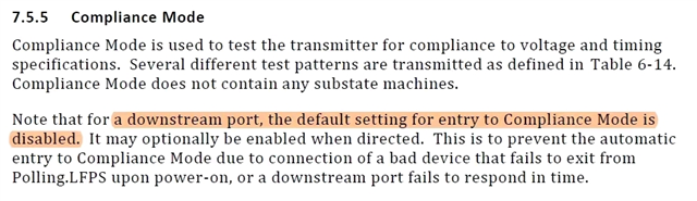

The reason to ask is that, according to the USB3.0 standard it mentions that, as a host, the compliance mode is disabled by default, and it needs SOC to enable it.

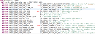

    For USB3.0, I had validated using the serdes_diag code and not on the EVM or using the Linux commands.
    For LFPS, I used the serdes diag to enable the TX_LFPS_EN bit and capture the output on the scope.
    CP1 is a clock at the Nyquist frequency (2.5GHz); so a continuous 0/1 pattern is to be sent out.
    For CP0, I used a pattern generator( BERT) which sent out the CP0 pattern into the device and loopback out onto the TX pins and into the scope for validating.

    It seems that there are two different ways to test CP0 & CP1 described below.
    1: Using Ping.LFPS to the Rx port of the DUT to toggle the compliance patterns. (This method means that our SoC should generate and send out the CP0 through the Tx by it self without BERT) This method is the suggested way by the vendor today, because they do not have the BERT.
    2: Using the BERT to generate the patterns on Rx and loopback to Tx then send to the scope. I think this method is just as you suggested.

    The idea about the BERT was to provide the pattern into the device while it is in loopback (RX to TX). Instead of the BERT, you could also use a pattern generator or AWG to send the CP0 pattern. CP1 can be provided from the device as I had mentioned earlier post using a 1-0-1-0 pattern in the SERDES diag code (set to SERDES_UDD and configuring the UDD pattern as below).
    I haven't done the 1st method while validating and hence I am unsure about the process.
