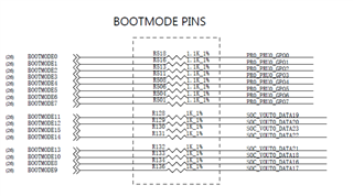

Hi TI Team,
we refer PROC114E3 demo board, but we delete U75 and U73 for cost down. some board is unstable, they can not boot from SD card sometime. The current is fixed, there are no boot steps. Could you tell me it is whether because of delete those buffer chips?
