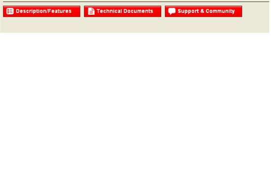

  • First of all, thank you very for your answer. But I am very sorry to tell you that I failed to find the CSL Folder. After clinking the Software & Tools button, i found no button to download the things i need. There is only a file about migration of csl 2.x to 3.x. But I found the CSL Folders used of 6457 in the same way. I donnot know if those fit  6455. Now I do need your help to let the DSPs work well. Thank your very much.
    3 buttons, but no download option, below.
  • We apologize for this error on the TI.com website. A report was made on this problem yesterday and I found 5 CSL pages that are broken, meaning without a download button. I will further escalate this problem now and will post back to this thread if I hear of it being fixed.
    The C6457 is similar, but I am not familiar with the detailed differences. That CSL may work for some features and may give you problems for others. We need to get the correct CSL available for you.
    RandyP
  • The TI.com problem has been resolved and you will now find the link for downloading the CSL files.
    Please let us know if you have any additional problems.
    RandyP
  • yeah, i got the CSL files from the website. thank you very much.
