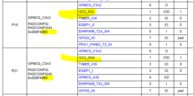

But no matter the i2cget, i2cdump, detect, I couldn't see any toggling of pin3/5.  I confirmed the pull-ups were causing these pins to be high.
I tested with and without an i2c device attached.
In case it did require an update to device tree, I did update my .dts file to contain:
// in the main_pmx0 section:
        main_i2c2_pins_default: main-i2c2-pins-default {
                pinctrl-single,pins = <
                        AM64X_IOPAD(0x00b0, PIN_INPUT_PULLUP, 0) /* (P19) I2C2_SCL */
                        AM64X_IOPAD(0x00b4, PIN_INPUT_PULLUP, 0) /* (R21) I2C2_SDA */
    &main_i2c2 {
            pinctrl-names = "default";
            pinctrl-0 = <&main_i2c2_pins_default>;
            clock-frequency = <400000>;
So with this change and a reboot, still not working, although it did change the I2C data rate!

For the record, from datasheet:

    Your pinmux settings are wrong. Looks like you are setting the pins to mux mode 0 when I would expect them to be mux mode 1.
    I typically suggest using the Sysconfig pinmux tool to help generate pinmux settings. Here's what I got when I checked the auto-generated "devicetree.dtsi" file from the sysconfig tool:

    			AM64X_IOPAD(0x00b0, PIN_INPUT, 1) /* (P19) GPMC0_CSn2.I2C2_SCL */
    			AM64X_IOPAD(0x00b4, PIN_INPUT, 1) /* (R21) GPMC0_CSn3.I2C2_SDA */

    This worked.  Thanks for the Sysconfig tip.  I had tried to use this in past, but and always selected the SDK then the part, so didn't see the dts generation.
    BTW, is there something about reading the TRM or datasheet I missed that would have clued me into the "1" vs. "0" I copied?

    The pinmux value is listed in the datasheet table that you linked above - you can see that the I2C signals are pinmux value 1 instead of pinmux value 0 (which is GPMC signals).
    As far as being able to tell that the third argument in function AM64X_IOPAD is the mux value (instead of something else like "enable/disable"), I am not sure of an easy way to do that. Taking advantage of the SysConfig pinmux tool to double-check your work is the best suggestion I can give.
