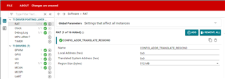

Hello TI,
I'm running a program on the MCU R5 core that gets booted by the kernel. The program's goal is to access the Main domain's SPI0 from the MCU domain. But when calling the MCSPI_transfer api, it doesn't return and hangs. Using the XDS110 debugger, I found it's waiting for the Tx Empty bit to be set.
I followed the steps from the link below to make sure the syscfg file is setup correctly. The dts is also updated to ensure there's no instances of main_spi0 defined and no spi0 pins are configured. The dts does however use spi1 so I left that defined. Lastly I configured the RAT so that it covers all of the MCSPI physical addresses.
https://dev.ti.com/tirex/explore/content/mcu_plus_sdk_am62ax_09_00_00_19/docs/api_guide_am62ax/MAIN_DOMAIN_PERIPHERAL_FROM_MCU.html#autotoc_md155
Is there anything else I'm missing with configuration? I've ran similar SPI code using the mcspi loopback test example and confirmed the MCU SPI is working.

mcspi1.$name                       = "CONFIG_MCSPI0";
mcspi1.useMcuDomainPeripherals     = false;
mcspi1.intrEnable                  = "POLLED";
mcspi1.mode                        = "MULTI_MASTER";
mcspi1.SPI.$assign                 = "SPI0";
mcspi1.mcspiChannel.create(3);
mcspi1.mcspiChannel[0].$name       = "CONFIG_MCSPI_CH0";
mcspi1.mcspiChannel[0].CSn.$assign = "SPI0_CS0";
mcspi1.mcspiChannel[1].$name       = "CONFIG_MCSPI_CH1";
mcspi1.mcspiChannel[1].CSn.$assign = "SPI0_CS1";
mcspi1.mcspiChannel[2].$name       = "CONFIG_MCSPI_CH2";
mcspi1.mcspiChannel[2].CSn.$assign = "UART0_RTSn";
addr_translate1.$name      = "CONFIG_ADDR_TRANSLATE_REGION0";
addr_translate1.localAddr  = 0xA0000000;
addr_translate1.systemAddr = 0x20000000;
debug_log.enableUartLog = true;
debug_log.enableMemLog  = true;
debug_log.uartLog.$name = "CONFIG_UART0";

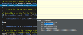

  • Hi Vaibhav,
    Thanks for your response. That's actually the same guide that I followed in my original post.
    I believe my address translation is correct because in the debugger, I can see the base addresses that are read from the mcspi registers all show the address of the local address that I set in RAT region. Are there specific changes that are needed in the dts other than removing the main_spi0 instance?
    Joseph

    I was able to get the Main SPI0 transfers from MCU working by removing the RAT region entry. This works when configuring for both polling and interrupt modes in syscfg. Is this expected?
    When exactly are we supposed to be using the RAT region? I thought this was required for whenever the MCU accesses a peripheral from the Main domain. It also says that in the link you and I provided.
    Joseph

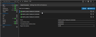

  • Thank you Vaibhav. After speaking with the TI team I was informed that some default configurations of the MPU in syscfg could be automatically translating the system address of the peripherals I'm accessing.
    Can you please point me to documentation on MPU regions and how/when they should be configured? I don't see this discussed in the link shared above.
    Joseph
  • Hello Joseph,
    Can you show us what you changed when you "removed the RAT region entry"?
    FYI, any time your R5F core accesses a memory region outside of the R5F subsystem, that access physically goes through the RAT circuitry. But typically for R5F cores, I do not see people configuring the RAT to do any address translation, so the memory access basically just "passes through".
    The information on this AM62Ax academy page is the information that I am aware of:
    https://dev.ti.com/tirex/explore/node?node=A__AXBsTEetU2hiTMZSzq4row__AM62A-ACADEMY__WeZ9SsL__LATEST
    When I check sysconfig, the RAT section is the only place I see to configure your RAT settings:
    I have NOT played around with this feature much within SysConfig (usually I'm manually editing the text of the example.syscfg file). So I cannot comment on whether SysConfig sneakily does stuff depending on whether you used the RAT to shift an address that is used by a peripheral or a shared IPC memory region.
    If I were you, I would NOT assume that the tool is doing magic for you. If you are using the RAT to shift addresses, you should manually check that your code, linker.cmd file, etc are using the correct address as documented in that academy page.
    Nick
  • Hi Nick,
    Thanks for your responses! Here's the .syscfg I'm currently using from the default ipc_rpmsg_echo_linux project. In this syscfg there's 3 RAT regions configured by default but none of them are mapping to the system address 0x20100000 (main MCSPI0) that I thought I needed to put in. After checking the linker file, it looks like these regions are there for the IPC shared memory and resource tables, is that correct?
    Also maybe the default MPU settings here are doing this configuration? It's a bit confusing though because I don't see the MCSPI system address or a range of it's address in the text syscfg either.
    addr_translate1.localAddr  = 0x9B000000;
    addr_translate1.systemAddr = 0x9B000000;
    addr_translate1.size       = 24;
    addr_translate2.$name      = "CONFIG_ADDR_TRANSLATE_REGION2";
    addr_translate2.localAddr  = 0x9C000000;
    addr_translate2.size       = 24;
    addr_translate2.systemAddr = 0x9C000000;
    addr_translate3.$name      = "CONFIG_ADDR_TRANSLATE_REGION1";
    addr_translate3.localAddr  = 0xA0000000;
    addr_translate3.systemAddr = 0xA0000000;
    addr_translate3.size       = 24;

    What I meant earlier when I said I removed the RAT region entry was that there was 0 of 16 regions added in this section. This was also when I was working in the hello world project.
    Joseph
  • Hello Joseph,
    Ahh, ok. I see what you are talking about now.
    Is address translation the issue?
    Those RAT address translations aren't actually doing anything. Notice how the localAddr and the systemAddr are the exact same value? So there isn't any remapping going on. And since all accesses outside of the R5F go through the RAT anyway, not configuring the RAT gives the same behavior as configuring the RAT to have localAddr = systemAddr.
    I do not think that address translation is your issue.
    Thanks, I do see how the addresses are the same. Just to close the loop on this, are you saying for my case in accessing a main peripheral from the mcu, I don't need to configure the RAT?
