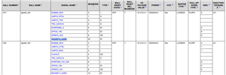

Can you please check if the Y27/Y29 signals are properly used ? A customer found It does not match with Datasheet in case Y27/Y29.
According to SK-TDA4VM schematic, It seems Y27 pin is to be used for MCASP11_AXR4 although Datasheet says it can be MCASP11_AXR5.
Please clarify on this.
