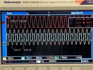

  • With the 800MHz image in the custom board, I try to probe some signals.
    LPDDR4_RESET_N goes high soon after power on.
    LPDDR4_CK_P gets a 50MHz signal after reset goes high, but it stops after ~2ms
    It seems there is a more fundamental problem...
    Power rails are looking OK, including VDDA_DDR_PLL0.and VDDA_PLL0.

  • Evan, the 50MHz is expected initially, as this would be the first frequency that is used during DDR training.  But this frequency should change to 800MHz at some point, to be able to train at that frequency.  So it appears that the initial point of the training isn't working.
    -Please check the voltage rails around the memory itself, including VDD_LPDDR4 (should be 1.1V) and VDD1_LPDDR4_1V8 (should be 1.8V)
    -do you mean that the 50MHz goes away after ~2ms?  No clock at all?  Check MCU_PORz, ensure it goes high and stays high
    -if possible, try to probe CKE as well.  This should go high and stay high, much like RESET_N (should go high after RESET_N goes high)
    -do you have JTAG access?  If you can connect Code Composer via JTAG, this can help narrow down where the issue is.  If so, i can give further instructions
    -do you see the same issue on multiple boards?  This can help identify assembly issues.

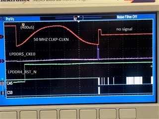

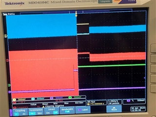

  • Hi James, thanks for the help.
    I obtained the LPDDR4 spec so understand the initialization a bit more, as you say the 50MHz for 2ms is normal at the start.
    MCU_PORz is staying high.  I will re-check the power rails next.
    Then will try to connect the JTAG.
    I have checked with two boards and have the same behavior.
    Here are some traces:
    Showing the 50MHz clock.  The P and N phases of the clock are not symmetrical but the resulting differential clock looks OK.  Is it normal?

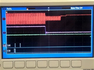

    Here you can see the end of the 50MHz clock (this scope cannot show 800MHz anyway but I think this flat line is true).  LPDDR4_RST_N stays high. Perhaps a problem of the source PLL?
    A more zoomed in view:

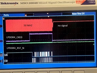

    Fully zoomed out showing LPDDR_RST_N and CKE0. CA activity continues after the clock ended and CKE0 went low??
  • Evan, i think you will need a faster scope to truly find out if the clock is going away.  I think it may actually be fine, you just can't see it with the scope you are using.  Everything else in the scope shots you sent look fine.  CKE is expected to go low during Command Bus Training, which would be when the clock switches to a higher frequency.
    May want to take a wider shot of the init sequence, to see what the signals do further in time.  CKE should go back high again eventually, and you should see another short time when the clock is 50MHz again (might depend on the memory you are using).  Eventually, CKE should stay high, and clock should be 800MHz.  This will help determine how far into the init sequence you are getting
    Definitely need to get JTAG working to better understand it.  Also the power checks are important.  Keep me posted.
    James
  • Hi James,

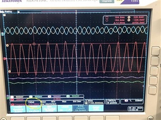

    Great diagnosis!  After a quick scope upgrade, the 800MHz is present (amplitude is quite small), and CKE does return high.  There are also two short bursts of 50MHz again before CKE goes high.
    I will confirm the power rails and then move on to connect the JTAG.  Thanks again.
  • Ok, great, so the training appears to be going thru the appropriate steps.  My guess is that training is either failing or not coming up with appropriate values.  We will be able to inspect these with JTAG and Code Composer.

    MAIN_Cortex_R5_0_0: GEL Output: --->>> DDR controller programming completed... <<<---
    MAIN_Cortex_R5_0_0: GEL Output: --->>> DDR PI programming in progress.. <<<---
    MAIN_Cortex_R5_0_0: GEL Output: --->>> DDR PI programming completed... <<<---
    MAIN_Cortex_R5_0_0: GEL Output: --->>> DDR PHY Data Slice 0 programming in progress.. <<<---
    MAIN_Cortex_R5_0_0: GEL Output: --->>> DDR PHY Data Slice 0 programming completed... <<<---
    MAIN_Cortex_R5_0_0: GEL Output: --->>> DDR PHY Data Slice 1 programming in progress.. <<<---
    MAIN_Cortex_R5_0_0: GEL Output: --->>> DDR PHY Data Slice 1 programming completed... <<<---
    MAIN_Cortex_R5_0_0: GEL Output: --->>> DDR PHY Address Slice 0 programming in progress.. <<<---
    MAIN_Cortex_R5_0_0: GEL Output: --->>> DDR PHY Address Slice 0 programming completed... <<<---
    MAIN_Cortex_R5_0_0: GEL Output: --->>> DDR PHY Address Slice 1 programming in progress.. <<<---
    MAIN_Cortex_R5_0_0: GEL Output: --->>> DDR PHY Address Slice 1 programming completed... <<<---
    MAIN_Cortex_R5_0_0: GEL Output: --->>> DDR PHY Address slice 2 programming in progress.. <<<---
    MAIN_Cortex_R5_0_0: GEL Output: --->>> DDR PHY Address Slice 2 programming completed... <<<---
    MAIN_Cortex_R5_0_0: GEL Output: --->>> DDR PHY programming in progress.. <<<---
    MAIN_Cortex_R5_0_0: GEL Output: --->>> Set PHY registers for all FSPs simultaneously (multicast)... <<<---
    MAIN_Cortex_R5_0_0: GEL Output: --->>> DDR PHY programming completed... <<<---
    MAIN_Cortex_R5_0_0: GEL Output: --->>> Set DDR to 25MHz for FSP F0... <<<---
    MAIN_Cortex_R5_0_0: GEL Output: --->>> DDR PI initialization started... <<<---
    MAIN_Cortex_R5_0_0: GEL Output: --->>> DDR CTL initialization started... <<<---
    MAIN_Cortex_R5_0_0: GEL Output: --->>> Inside DDR_Change_freq_ack function ... <<<---
    MAIN_Cortex_R5_0_0: GEL Output: --->>> Waiting for first frequency change request ... <<<---
    MAIN_Cortex_R5_0_0: Trouble Reading Memory Block at 0x63014080 on Page 0 of Length 0x4: (Error -1205 @ 0x63014080) Device memory bus has an error and may be hung. Verify that the memory address is in valid memory. If error persists, confirm configuration, power-cycle board, and/or try more reliable JTAG settings (e.g. lower TCLK). (Emulation package 12.6.0.00029)
    AM62_DDR_Initialization_ECC_Disabled() cannot be evaluated.
  • Evan, something still doesn't seem right.  Did you setup a Target Configuration with AM62Ax?  Your log shows MAIN_Cortex_R5_0_0, but there is no MAIN R5 on AM62A.  Below is what it should look like.  Ensure you have chosen AM62Ax for the device, and that you connect to WKUP_R5FSS to run the GELs
    REgards,
    James
  • Hi James,
    Sorry for the slow reply.
    Yes, my mistake, for the above screenshot I had clicked on the wrong R5 line.  Here is what happens using the init script with WKUP_R5SS0_0, without boot volume:
    DDR not initialized with R5 connect.
    Go to menu Scripts --> AM62 DDR Initialization -> AM62A_DDR_Initialization_ECC_Disabled to initialize DDR.
    WKUP_R5FSS0_0: Trouble Writing Memory Block at 0xf300120 on Page 0 of Length 0x4: (Error -1065 @ 0xF300124) Unable to access device memory. Verify that the memory address is in valid memory. If error persists, confirm configuration, power-cycle board, and/or try more reliable JTAG settings (e.g. lower TCLK). (Emulation package 12.6.0.00029)
    AM62A_DDR_Initialization_ECC_Disabled() cannot be evaluated.
    Target failed to write 0x0F300120
    at *((unsigned int*) (AM62A_DDRSS_SS_BASE+0x120))=(unsigned int) 0x00 [ddrss_ti_wrapper.gel:40]
    at TI_disable_ECC() [AM62A_ddr_top.gel:109]
    at AM62A_DDR_Initialization_ECC_Disabled()
    And here, with boot volume:
    WKUP_R5FSS0_0: GEL Output: Running from R5
    WKUP_R5FSS0_0: GEL Output: DDR programming has already been attempted.
    WKUP_R5FSS0_0: GEL Output: DDR Initialization GEL script is being skipped...

    Tag teaming with James here, the logs seem to indicate that the training is failing very early on; one of the first trainings that are done by the DDRSS is CA and CS training and those are both returning failures.
    Can we scope the Power Ramp (so Ta to Tb in JEDEC) and the Reset (Tb to Tc ) portions for the DRAM on the board? I'd like to double check both against the JEDEC spec (Voltage Ramp and Device Initialization section).
    • Voltage Ramp main items:
      • VDD1 always greater than VDD2, VDD2 always greater than VDDQ -200mV
      • Ramp sequence takes less than 20ms
      • VDD1 = 1.8V , VDD2 = 1.1 V, VDDQ = 1.1V
    • Reset main items:
      • Reset low for at least 200 us after power supplies have ramped
      • At least 10ns before reset goes high, CKE goes low
    In parallel we're trying to get around the training at a slow speed, this is not the normal operation so it's taking some effort to work around get it running.
    Sincerely,
    Lucas

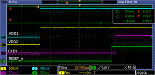

  • Hi Lucas, thanks for the help.
    Here is the ramp of VDD1 and VDD2, VDD1 > VDD2 and the ramp takes about 1ms.
    VDDQ pins are tied to VDD2.
    The reset apparently is released after 500ms. CKE0 is already low at that time.
  • Hey Evan,
    Thank you for the scope shots, the power up and reset sequence looks good. We're still working on the slow speed config to bypass training but it's still taking some time.
    Sincerely,
    Lucas
