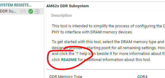

  • Jonathan, release notes for the DDR Register Configuration tool specifically will be in the README link at the top of the page in the tool.  That will explain the differences between v0.09.09 and v0.10.01
    James
  • Thanks for the pointer, I found the change logs but am still confused as to what the changes are for.

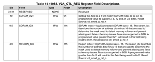

  • Hi Jonathan, the PI_TPARITY_ERROR_CMD_INHIBIT_x  depends on tPAR_ALERT_PWmax, which you specify in the tool.  Is that value by chance different than before in your configuration?
    The DDRSS_SDRAM_IDX field is new and is intended for future revisions of the driver that will use it.  It is the value that is intended for the SDRAM_IDX field in the DDR wrapper register (see below).  This value gives the DDRSS wrapper information on the size of the memory on your board, so it can block unintended addresses and eliminate any memory aliasing.
    James
    Thanks, your right. I used the DDR4-1600 settings instead of the DDR4-3200 ones which the SK was using. Reverted my config changes to keep in sync with the evm.
    Okay, I assume the 11h default is enough for 4GB of ram then?  I shouldn't have to tweak it in u-boot 2021?
  • Jonathan, yes, anything equal or larger than how SDRAM_IDX is defined will work, but realize that using a larger number won't allow the DDR wrapper to identify aliased addresses.  So if you keep it at 17 (11h), it will think there is an 8GB memory and won't report any memory aliasing in the 8GB range
