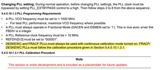

  • Acc. to the TRM (SPRUIL1C) chapter "5.4.5.10.1.3" a PLL VCO must be >1500MHz (see below), but it contradicts to the TI default configuration:
    Q1: Is this requirement regarding minimal PLL VCO valid or not?

  • The following extract from the TRM requires calibration procedure to be done for a PLL:
    Calibration procedure is not present in either “B” or “C” revisions of the TRM.
    Q4: What is the correct calibration procedure?

    we will double check cause our analysis shows that value from TISCI documentation seems to reflect the real configuration done by TI SBL, but it differs from the table you provided above. But to prevent misunderstanding: is the requirement that VCO must be >1500MHz valid and we need to fulfill it?
    And could you please take a look and give feedback regarding other points.
    Dmitry
  • You are right... I took this from a different device. Sorry!
    Please program all PLLs so that their VCOs are 1500MHz or greater.
