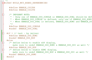

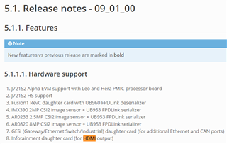

I want to use HDMI instead of eDP.
So, I decided to use ENABLE_DSS_HDMI in app_cfg_mcu2_0.h. (#define ENABLE_DSS_HDMI and #undef ENABLE_DSS_EDP)
In the vision_apps_init.sh log, it shows that the configuration is set to HDMI, but it seems unable to find the display.
Is there any guidance on using HDMI?

[MCU2_0] 12.844044 s: FVID2: Init ... Done !!!
[MCU2_0] 12.844064 s: SCICLIENT: Sciclient_pmSetModuleState module=219 state=2
[MCU2_0] 12.844136 s: SCICLIENT: Sciclient_pmSetModuleState success
[MCU2_0] 12.844169 s: DSS: Init ... !!!
[MCU2_0] 12.844186 s: DSS: Display type is HDMI !!!   <====================================================
[MCU2_0] 12.844203 s: DSS: M2M Path is enabled !!!
[MCU2_0] 12.844220 s: DSS: SoC init ... !!!
[MCU2_0] 12.844234 s: SCICLIENT: Sciclient_pmSetModuleState module=158 state=0
[MCU2_0] 12.844282 s: SCICLIENT: Sciclient_pmSetModuleState success
[MCU2_0] 12.844306 s: SCICLIENT: Sciclient_pmSetModuleState module=158 state=0
[MCU2_0] 12.844349 s: SCICLIENT: Sciclient_pmSetModuleState success
[MCU2_0] 12.844368 s: SCICLIENT: Sciclient_pmSetModuleClkParent module=158 clk=5 parent=7
[MCU2_0] 12.844496 s: SCICLIENT: Sciclient_pmSetModuleClkParent success
[MCU2_0] 12.844517 s: SCICLIENT: Sciclient_pmSetModuleClkFreq module=158 clk=5 freq=148500000
[MCU2_0] 12.845398 s: SCICLIENT: Sciclient_pmSetModuleClkFreq success
[MCU2_0] 12.845422 s: SCICLIENT: Sciclient_pmModuleClkRequest module=158 clk=5 state=2 flag=0
[MCU2_0] 12.845630 s: SCICLIENT: Sciclient_pmModuleClkRequest success
[MCU2_0] 12.845653 s: SCICLIENT: Sciclient_pmSetModuleState module=158 state=2
[MCU2_0] 12.845827 s: SCICLIENT: Sciclient_pmSetModuleState success
[MCU2_0] 12.845846 s: DSS: SoC init ... Done !!!
[MCU2_0] 12.845863 s: DSS: Board init ... !!!
[MCU2_0] 12.845878 s: DSS: Board init ... Done !!!
[MCU2_0] 12.846676 s: DSS: Display is not connected   <====================================================
[MCU2_0] 12.846710 s: DSS: Init ... Done !!!
