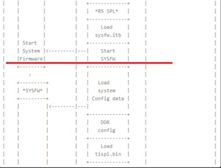

This is my current state of booting:
  • R5 SPL (U-Boot/tiboot3.bin) loaded by R5 ROM and executed successully
    • tested via USB DFU and UART
    • R5 SPL loads SYSFW (sysfw.itb)
    • R5 SPL tries to start SYSFW on DMSC and hangs
    By debugging, I could locate the issue a bit more specific:
    SYSFW takes the path via "Firmware certificate authentication failed".
    I generated and signed SYSFW as described.

    Do I need a dedicated SYSFW for DRA829JMT0BALFQ1 HS-FS? Any other requirements I my have missed?

      • R5 SPL loads SYSFW (sysfw.itb) in the R5 SRAM
      As DDR initialization has not happend yet, DMSC should not have an issue with the DDR (red bar marking the hang):
      Daniel will append the generated files.
      I think we need to find the reason for the authorization failure...
