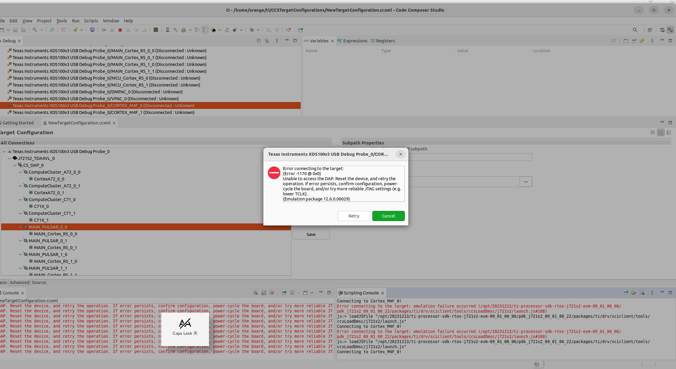

Dear TI,
I'm using AM68A HS-FS chip on my custom board(I have SK-AM68 both),using the ti-processor-sdk-rtos-j721s2-evm-09_01_00_06.
I follow the steps to setup CCS:ti-processor-sdk-rtos-j721s2-evm-09_00_01_01-docs_only/pdk_j721s2_09_00_01_04/docs/userguide/j721s2/ccs_setup_j721s2.html
it would be faild to connect to M4F
I've changed the pdk path in launch.js, here is the js file. So how can I connect the HS-FS device with JTAG in CCS.
  • There has some problem to deliver the js FILE:

  • Hi Chen,
    The Cortex-M4 Cores are the primary Security processor cores in the TDA4AL device. The SMS Cortex-M4 Core0 is protected against JTAG connections on any HS device (HS-FS or HS-SE), so above error is expected.
    You can only connect to the non-security cores using CCS on a HS-FS device.
    regards
    Suman
  • Hi Suman,
    Thanks for your reply.
    I know ti well for HS-FS.In my understanding, I can use sbl boot all core with app img, when all core boot up, can it be connect to jtag?
    Sincerely
  • Hi Chen,
    Yes, you can connect to any core outside of the SMS Cortex-M4 cores, as long as they are out of reset.
