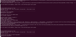

I'm using AM68A HS-FS chip on my custom board(I have SK-AM68 both),using the ti-processor-sdk-rtos-j721s2-evm-09_01_00_06.
I have been boot MPU and MCU core use UART.
when I used to flash ospi image to Solidify my boot file,there are some prolem.
I follow the step that rtos sdks recommands:
./dslite.sh --mode processors -c /dev/ttyUSB1 -f /opt/ti/uniflash_8.5.0/processors/FlashWriter/j721s2_evm_hs_fs/uart_j721s2_evm_flash_programmer_release.tiimage -i 0
./dslite.sh --mode processors -c /dev/ttyUSB1 -f /opt/20231213/ti-processor-sdk-rtos-j721s2-evm-09_01_00_06/pdk_j721s2_09_01_00_22/packages/ti/boot/sbl/binary/j721s2_evm/ospi/bin/sbl_ospi_img_mcu1_0_release.tiimage -d 0 -o 0
first command can transfer well.but the ospi image will stuck int somewhere which below:
it will not show the progress.
it's same in SK-AM68 and my custom board.
