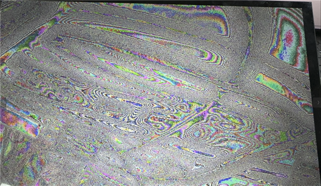

Hi TI experts,
My software version is:
  PDK-RTOS :processor-sdk-rtos-j721e-evm-08_06_00_12
  PDK-LINUX:processor-sdk-linux-08_06_00
date flow:
Single 1920x1536 YUV422_8 capture  -  DSI -  LCD(1280x800(RGB565))
Capture is normal when viewed offline. Judging from the phenomenon, the LCD display is updated in real time with the camera acquisition, but the display effect is abnormal.
I set /* Display initialization */ to 1280x800 in app_single_cam_main.c; what settings did I miss?
Looking forward for your reply, thank you
Barry
  • Attached is my capture picture cap_0001.yuv and log:
    cap_0001.zip
    p i 288...

  • Hi Berry,
    Looking at the display, it seems there is issue in component ordering. like capture is outputting in uyuv format and display is in yuyv format. Can you try changing format for YUV422 and see if it helps?
    Brijesh
  • Hi Brijesh,
    Your replies are always useful.
    We have tried changing it, but the display still looks abnormal and there is not much change.

  • Hi Barry,
    Looking at the image, it is definitely stored in YUYV format, where luma data is in the lower byte. But looking the above image again, it may not be just component ordering issue, it looks like some msb bits missing in the image. Are you sure that you are directly connect CSI output to directly. There is no other module in between them? Also please confirm that you are not using CSITX, it is DSI output, via DSS?
    If this is the case, we can read back few register in DSS to check if the format is setup correctly in the DSS first. Which display pipeline are you using in DSS?
    Brijesh
  • Hi Brijesh,
    thank you for your reply.
    1.What is confusing is that when the data type is {VX_DF_IMAGE_UYVY, 7}, the picture after our savaimage looks normal.
    The camera output format is confirmed to be:   1920*1536 yuv422_uyvy:
    2.The DSI data flow is: DSI-max96789-max96752-lcd
    Because our screen is 1280*800 (RGB565), the DSI output has been modified as follows:

    3.We also confirmed the max96752 deserializer, 0x108 value is 62,detect OK
    Now the display is abnormal. Did we miss any modifications?
    Looking forward to the expert's reply, thanks
    Barry
  • Hi Barry,
    But who converts from RGB888 to RGB565? As per below macro in packages\ti\drv\dss\src\drv\dctrl\dss_dctrlDsi.c file, DSI output is fixed to RGB888 format. so wondering how it gets converted to RGB565.
    #define DSITX_VID_DATA_TYPE (DSITX_VID_DATA_TYPE_RGB_24)
    #define DSITX_VID_PIX_MODE (DSITX_VID_PIXEL_MODE_RGB_24)
    Brijesh
  • Hi Brijesh,
    But do you think the reason for this problem is that DSI has not been converted to 565 output?
    Ignoring the problem that the screen only displays RGB565, I think if there is no problem with the modification, at least I can see a basically clear image, right? But now the picture I see is vague.
    1920X1536 UYVY acquisition is displayed on a 1280x800 RGB888 screen through DSI output. Is this supported?
    Barry
  • Hi TI experts,
    Can you update this question for us?Looking forward to your reply.
    Barry
  • Hi Barry,
    Well, yes, if the msb bits are missing, it can look like the above image.
    Yes, that's correct. Have you tried this display with any other application? just to rule out format differences. Lets say, can you try display only application and see if display is first working fine?
    Yes, this can be supported. Essentially, here, DSS will convert input YUV data into RGB888 format and output over DSI interface.
    Brijesh
