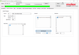

    For explicit communications, you can access any attribute of custom classes/instances you have set up.
    See 'app_generic_device.c', function EI_APP_GENERIC_DEVICE_cipGenerateContent().
    There you can see how class (id:0x70), instance (id:0x1) and attributes (120 of various types, starting from id:0x300) are created.
    Running the “generic device” example, you can make explicit calls against that class:
    Please, let us know if this is helpful or if we are misunderstanding your requirement ?

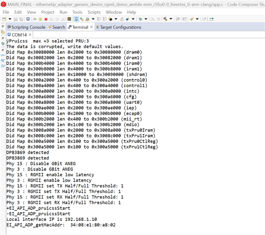

  •   Hi Ashwani,
         After detailed analysis we still see Explicit messages are not supported. We are able to fetch the information from the Class/instance/Attribute to controller as static information. However, this is possible only if the Class is updated in  EI_APP_GENERIC_DEVICE_run(). All implicit messages/Cyclic data are handled in this function.
    We could not find how the Explicit message are update in the class outside of  EI_APP_GENERIC_DEVICE_run() function.
      Appreciate if you could provide insight into how Explicit message are updated and the API for the same.
    Thank You
  • logs we observed an error that that data is corrupted
    This message “The data is corrupted, write default values.“ comes from non-volatile memory read, where the configuration data are stored. This message we expect on any new board where you run stack for first time. It’s displayed just one time on start to write factory configuration data to non-volatile memory.
    This should have no impact to execution, because the default data are used for first time. After reset you should not see this message again because configuration data are already present in non-volatile memory.
    If you will see that message after next reset than the issue can be really wrong data, because on read we are making some checks to be sure that data are not incorrect.
    On the other hand, it would be helpful if you could you also let me know more details on what we are trying to achieve and what is your approach ?
    Best Regards
    Ashwani

    The explicit messages need to be handled the same way as implicit messages. That means following initialization steps:
    • create class (by using EI_API_CIP_createClass, see EI_APP_GENERIC_DEVICE_cipGenerateContent)
    • create instance (by using EI_API_CIP_createInstance, see EI_APP_GENERIC_DEVICE_cipGenerateContent)
    • create attribute (by using EI_API_CIP_addInstanceAttr, see EI_APP_GENERIC_DEVICE_cipGenerateContent)
    • create service (by using EI_API_CIP_addInstanceService, see EI_APP_GENERIC_DEVICE_cipGenerateContent)
    • configure and initialize value (by using EI_API_CIP_setInstanceAttr, see EI_APP_GENERIC_DEVICE_cipGenerateContent)
    On side of application based on required behavior you can update the attribute value by EI_API_CIP_setAttr_usint or by any other EI_API_CIP_setAttr_xxxx function based on type of attribute.
    Based on expected behavior:
    For cyclic update user can use EI_APP_GENERIC_DEVICE_run function.
    For event based user can use any event callback function defined in application (by user).
    Note:
    Our EtherNet/IP Adapter device is acting only as server in client-server communication. Client feature is not supported. That means our device sends always response on request of any client. Is not able to send any request.
    Best Regards
    Ashwani

  • Hi Ashwani
    Thanks for helping us on explicit message.
      We have followed the above instruction and were able to get the data on controller.
    Thank you.
    Mamatha B M
  • We have followed the above instruction and were able to get the data on controller.
