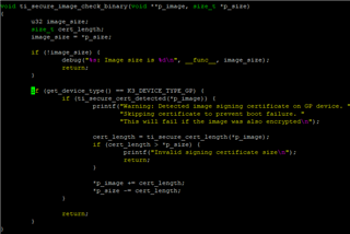

  • Hi Bo,
    OK, thanks. Since we haven't written any keys yet, it is definately NOT an HS-SE device. But I was puzzled by the print debug saying "GP device".
    I looked through the code, and this error is definitely generated on a GP device only.
    The get_device_type() defined in <U-Boot>/arch/arm/mach-k3/common.c will not return TYPE_GP if it is not a GP device.
    Can you confirm if it is possible or not to bind mcu_uart0 to H26 H27 and still be able to perform OTP programming.
    ROM is looking for these pins only for UART Boot. This just means you cannot run KeyWriter using UART boot-mode. UART boot-mode is the most common to easily identify the device as GP or HS-FS or HS-SE and to identify the SoC UID for JTAG unlocking without any software. You have to rely on s/w now to retrieve these, and need to rely on your QSPI or USB boot-modes for KeyWriter.
    You need to ensure your PinMux configuration as you already mentioned.
    regards
    Suman
    PS: I am out on vacation early next week, so will not provide any responses until Thu.
  • Hi Suman,
    Thank you for diving into the code. After contacting TI about our HS-samples, it is confirmed that those are NOT HS-variants, but
    just DRA829 GP-variants, which explains why I have had troubles getting any output.
    I will have to postpone these investigations until we have received correct variants of the SoC.
    One last question that is of utmost importance to us: is it necessary to perform OTP burning from the MCU domain, or can it be performed from other domains as well?
    /Bo
