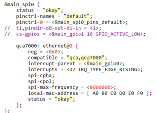

After modifying the DTS and adding the QCA7000 driver, Linux fails to detect QCA7000 on the SPI bus during boot.
The modified results are as follows:
Output errors:
root@am62xx-evm:~# dmesg | grep spi1
[    1.526928] qcaspi spi1.0: ver=0.2.7-i, clkspeed=8000000, burst_len=5000, pluggable=0
[    1.534950] qcaspi spi1.0: Invalid signature (0xFFFF)
[    1.540113] qcaspi: probe of spi1.0 failed with error -14
The identified problem is that EXP_SPI0_CLK is not generating the expected output during Linux boot.
Is our modification correct, or did we miss anything?
Do you have any suggestions? Looking forward to your reply. Thank you.

  • Sorry for the late reply. We've tried the methods mentioned above, but it still doesn't work.
    Then, we saw this related thread here: https://e2e.ti.com/support/processors-group/processors/f/processors-forum/1280645/sk-am64b-spi1-not-working?tisearch=e2e-sitesearch&keymatch=QCA#
    We have modified the k3-am625-sk.dts file as follows:

    &main_spi0 {
    	status = "okay";
    	pinctrl-names = "default";
    	pinctrl-0 = <&main_spi0_pins_default>;
    	ti,pindir-d0-out-d1-in;
    //	cs-gpios = <&main_gpio1 16 GPIO_ACTIVE_LOW>;
    	qca7000: ethernet@0 {
    		compatible = "qca,qca7000";
    		reg = <0x0>;
    		interrupt-parent = <&main_gpio0>;
    		interrupts = <38 IRQ_TYPE_EDGE_RISING>;
    		spi-cpha;
    		spi-cpol;
    		spi-max-frequency = <8000000>;
    		local-mac-address = [ A0 B0 C0 D0 E0 F0 ];
    But it also doesn't work.
    [ 5.381390] qcaspi spi1.0: ver=0.2.7-i, clkspeed=8000000, burst_len=5000, pluggable=0
    [ 5.396109] qcaspi spi1.0: Invalid signature (0x0000)
    [ 5.411051] qcaspi: probe of spi1.0 failed with error -14
    Is the spi interrupt configuration correct? Since we have configured (V25) GPMC0_WAIT1.GPIO0_38, GPIO-458 should appear, right?

  • Thank you for your reply. We have tested the light bar, it can light up. We can also observe the clock signal. The changes are as follows.
    &main_pmx0 {
        spi1_pins_default: spi1-pins-default {
            pinctrl-single,pins = <
                AM62X_IOPAD(0x01bc, PIN_INPUT, 0) /* (A14) SPI0_CLK */
                AM62X_IOPAD(0x01b4, PIN_INPUT, 0) /* (A13) SPI0_CS0 */
                AM62X_IOPAD(0x01c0, PIN_INPUT, 0) /* (B13) SPI0_D0 */
                AM62X_IOPAD(0x01c4, PIN_INPUT, 0) /* (B14) SPI0_D1 */
    &main_spi0 {
        status = "okay";
        pinctrl-0 = <&spi1_pins_default>;
        spidev@0 {
            spi-max-frequency = <6250000>;  /* 6.25 MHz */
            reg = <0>;
            compatible = "rohm,dh2228fv";
    Later, when we tried to use the same pin to connect the QCA7005, following the modifications as mentioned above, it failed. We don't see the clock signal. The obvious differences are that 'spidev@0' has changed to 'qca7000: ethernet@0', and there are changes in the contents inside.
    Leo
  • Later, when we tried to use the same pin to connect the QCA7005, following the modifications as mentioned above, it failed. We don't see the clock signal. The obvious differences are that 'spidev@0' has changed to 'qca7000: ethernet@0', and there are changes in the contents inside.

  • Thank you for your help, it can work now.
    However, we still cannot determine what the problem is. Originally, the QCA7005 was on another board, and we connected it using wires to the SK-AM62B-P1. Now, with our custom board where the QCA7005 is on the board, we have succeeded.
    Thank you once again for your assistance.

  • Yes, this issue can be closed. Below is the final device tree we changed, provided for reference. Thanks.
    &main_spi2 {
    	status = "okay";
    	pinctrl-0 = <&main_spi2_pins_default>;
    //	ti,pindir-d0-out-d1-in;
    		reg = <0>;
    		pinctrl-0 = <&main_qcairq_pins_default>;
    		interrupt-parent = <&main_gpio1>;
    		interrupts = <10 IRQ_TYPE_EDGE_RISING>;
    		spi-cpha;
    		spi-cpol;
    		status = "okay";
    Leo
