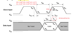

Customer use AM623x SDIO to connect CC3300, they found SDIO CLK/DATA hold time is too small.
Base on CC3300 spec in HS input, tIH should be 2ns
Ref Spec, p16
https://www.ti.com/lit/ds/symlink/cc3300.pdf?ts=1706922434267&ref_url=https%253A%252F%252Fwww.ti.com%252Fproduct%252FCC3300%253FkeyMatch%253DCC3300%2526tisearch%253Dsearch-everything%2526usecase%253DGPN-ALT
But customer's chart as below :
(blue is clock, green is data)
tIH should be 2ns at least, but customer measure is 0.32ns
so we think it have setup time / hold time risk, even data receiver correct in SW side

  • As mentioned in the other E2E thread, the MMCSD host will transition data on the falling edge of CLK when operating in Default Speed Mode or High Speed Mode. Your software should have the MMCSD host configured to operate in High Speed Mode to communicate with the CC3300 device. That does not appear to be the case when looking at the timing CLK to DAT timing relationship shown in the scope capture. It looks like your software has the device configured to operate in UHS-I SDR25 Mode. UHS-I SDR25 mode is only valid for UHS-I cards, not embedded SDIO devices.

  • Hi Gibbs,
    Please refer to sdhci1 or sdhci2 node (depending on which interface the CC3300 device is attached to) in kernel device tree file k3-am62-main.dtsi. Please remove all properties 'ti,otap-del-sel-*' except ti,otap-del-sel-legacy and ti,otap-del-sel-sd-hs. This will ensure the device is only enumerated up to High Speed mode.
