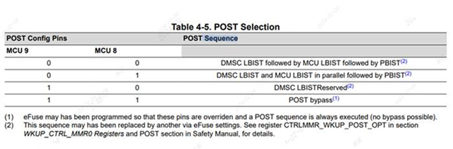

Our latest PCBA use XJ784S45AALY-HS-SE-FS for eFuse programing,found several Soc cannot boot from ospi , there is no data and clk waveform about ospi when power on,
attempted to make some modifications as below。
MCU[9:8] 11 , can boot;
MCU[9:8] 01 , cannot boot;
MCU[9:8] 00 , can boot;
According to the specification,MCU[9:8] are the POST config pins,
What's the reason for the above.
Which POST  sequence we should use ,what determines the configuration of MCU[9:8]。

  • Add more information:
    Post config Pins
    When the set MCU[9:8] 01, it can't start up. The details of phenomenon show as follow:
    OSPI flash data and clock no signal
    1.We have already double confirmed BOOT MODE pins was set correct.
    2. Power supply for MCU domain was normally because MCU_PORZ in high level state.
    3. There are two chips that will definitely reproduce this problem. Two chips accidentally reproduced this problem. Most of the chips are in normal condition
  • Hi Kangjia,
    As you rightly pointed out, these pins are used to select different modes of POST settings. We will have to check with the HW team why BIST running in parallel is not working. Does it work fine in any other boot mode? Is it the issue only in ospi boot mode?
    But I think setting it to 00 is working fine, which means BIST running in serial seems to be working fine, isn’t it? Any issue in running this setting?

    Can you summarize how many systems have been built/tested and how many are seeing this issue?
    Can you read and report these register values:

    update the register value show as following:
    CTRLMMR_WKUP_DEVSTAT:0x308
    CTRLMMR_POST_SEL_STAT:0x0
    CTRLMMRPOST_OPT:0xa0f0e
    CTRLMMR_SMS LBIST_CTRL:0x0
    CTRLMMR_SMSLBIST_PATCOUNT:0x0
    CTRLMMR_SMS LBISTSEEDO:0x0
    CTRLMMR_SMS LBIST SEED1:0x0
    CTRLMMR_SMS_LBIST_STAT:0x0
    CTRLMMR SMS LBIST_MISR:0x61400000
    CTRLMMR SMS LBISTSIG:0x0
    CTRLMMR_MCULBISTCTRL:0x0
    CTRLMMR_MCULBISTPATCOUNT:0x0
    CTRLMMRMCULBISTSEEDO:0x0
    CTRLMMR_MCU_LBIST_SEED1:0x0
    CTRLMMR_MCU_LBIST_STAT:0x0
    CTRLMMR_MCU_LBIST_MISR:0x61400000
    CTRLMMR_MCULBIST_SIG:0x0
    CTRLMMRWKUP POST STAT:0x0
    CTRLMMRWKUP POSTCFGO:0x3501005c
    CTRLMMRWKUP_POST_CFG1:0x3501006f
  • Kangjia,
    There are several register values that are questionable. Is this a very early sample??
    Please try with another device.
    I cannot explain why the part does not boot, but I can tell you that you are not really running a self-test.

  • There are a couple of things that are strange -- one is that the pattern count is 0.
