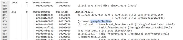

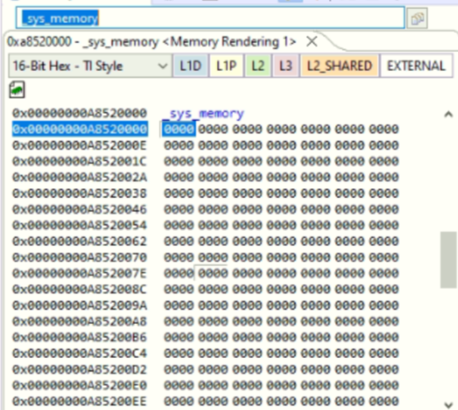

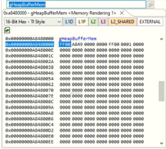

    I have another question regarding the linker files , I am trying to create a very simple application which will make use of the heap region and as per the .lds file the heap is allocated on DDR_SPACE with size 0x20000 as given below.
    1. I declared a global buffer for my application in this way "int16_t gHeapBufferMem[HEAP_TOTAL_SIZE/sizeof(int16_t)] __attribute__((aligned(HeapP_BYTE_ALIGNMENT)))" in my .c file and I could see in the memory browser that by default it is allocating the buffer on DDR_SPACE like this
    2. When I try to get the actual heap address as per the .lds file I am able to see the _sys_memory which is also on DDR_SPACE
    My question is how the linker is able to allocate the global buffer on DDR_SPACE by default , is there any memory configuration which will perform heap allocation on DDR_SPACE by default ?
    And also If we want to get access to the total heap size as given in .lds in our .c file how to get it ?

  • I will share the file content here by inserting it as code format , I hope it will be useful this way

    Madhu
  • Hi Madhu,
    Global variables/buffers get allocated in the .bss section of the memory and not the heap. You can see this from the map file as well
     heap on the other hand is used for dynamic memory allocation during the runtime of the program.
    Since your .bss in also in DDR_SPACE in the linker file, you are seeing the gHeapBufferMem there. If you move .bss to some other location, you should be able to see gHeapBufferMem at a different location as well

    I understand the reason behind the gHeapBufferMem getting allocated on the DDR SPACE , so now I tried allocating the same buffer on the actual heap region like this ,
    "int16_t gHeapBufferMem[HEAP_TOTAL_SIZE/sizeof(int16_t)] __attribute__((section(".sysmem"),aligned(HeapP_BYTE_ALIGNMENT)));"
    The only issue which I am facing while compiling this file now is , as shown below
    Every time I compile after adding the actual section given in the linker file I am getting this issue , like it is asking for extra 2 bytes in that buffer how to address this issue ?
    Madhu
  • Hi Madhu,
    Looks like first two bytes of .sysmem is getting allocated to rts_7100_le.lib, which is why you are seeing that error.
    Do you have a specific use case where you want to use the complete heap space in the form of gHeapBufferMem?
    Parth
