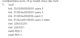

  • Hi Milan,
    Have you tried running the following to make sure your mac multicast addresses are as expected?
    $ip maddr show dev hsr0
    -Daolin
    yes this is fine too.. we did add/del without issue
  • Hi Milan,
    Are you able to share the results of $ip maddr show dev hsr0?
    -Daolin

    root@am64xx-evm:~# ip maddr show dev hsr0
    7:      hsr0
            link  33:33:00:00:00:01 users 3
            link  01:00:5e:00:00:01 users 3
            link  33:33:ff:1f:3d:c5 users 3
            link  01:00:5e:00:00:fb users 3
            link  33:33:00:00:00:fb users 3
            link  01:00:5e:00:00:fc users 3
            link  33:33:00:01:00:03 users 3
            inet  224.0.0.252
            inet  224.0.0.251
            inet  224.0.0.1
            inet6 ff02::1:3
            inet6 ff02::fb
            inet6 ff02::1:ff1f:3dc5
            inet6 ff02::1
            inet6 ff01::1
    root@am64xx-evm:~# ifconfig hsr0

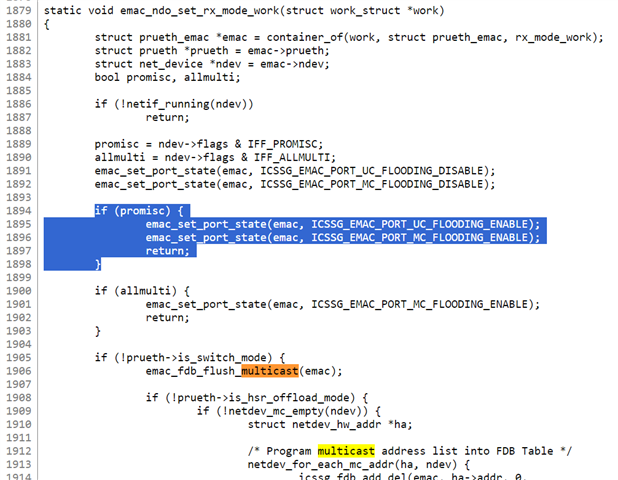

    [  131.947093] device eth1 entered promiscuous mode
    [  131.947219] audit: type=1700 audit(1651489475.852:3): dev=eth1 prom=256 old_prom=0 auid=4294967295 uid=0 gid=0 ses=4294967295
    [  131.971118] device eth2 entered promiscuous mode
    [  131.971512] audit: type=1700 audit(1651489475.852:3): dev=eth2 prom=256 old_prom=0 auid=4294967295 uid=0 gid=0 ses=4294967295
    [  132.034954] audit: type=1300 audit(1651489475.852:3): arch=c00000b7 syscall=211 success=yes exit=32 a0=3 a1=ffffd5286bf8 a2=0 a3=ffffae6b7840 items=0 ppid=1082 pid=1093 auid=4294967295 uid=0 gid=0 eui)
    [  132.034985] audit: type=1327 audit(1651489475.852:3): proctitle=6970006C696E6B0064656C6574650068737230
    7:      hsr0
            link  33:33:ff:1e:9f:30 users 3
            inet  224.0.0.1
            inet6 ff02::1:ff1e:9f30
            inet6 ff02::1
            inet6 ff01::1
    root@am64xx-evm:~# sh ./hsr_setUp.sh hsr_hw eth1 eth2 192.168.2.20
    8:      hsr0
            link  33:33:00:00:00:01 users 2
            link  01:00:5e:00:00:01 users 2
            link  33:33:ff:1e:9f:30 users 2
            inet  224.0.0.1
            inet6 ff02::1
            inet6 ff01::1

    Hello, we indeed have the same issue.
    eth1 is getting in promiscuous mode
  • Indeed eth1 is getting in promiscuous mode when we load hsr offload twice !

    Based on you also seeing eth1 entering promiscuous mode, I'm assuming you may have attached the wrong boot log?
    Additionally, are you able to test out if the HSR double load issue has been fixed in your setup? If you verify it has been fixed, you might just need to run the HSR offload setup script once for your multicast testing as it was mentioned for the first run of the script, the multicast filtering works as expected. The double run of the HSR offload script seemed to be solely for the workaround for the previous double firmware load issue.

    [  264.375483] device eth1 entered promiscuous mode
    [  264.375592] audit: type=1700 audit(1651974563.656:3): dev=eth1 prom=256 old_prom=0 auid=4294967295 uid=0 gid=0 ses=4294967295
    [  264.403463] device eth2 entered promiscuous mode
    [  264.403566] audit: type=1700 audit(1651974563.656:3): dev=eth2 prom=256 old_prom=0 auid=4294967295 uid=0 gid=0 ses=4294967295

    [  267.819630] icssg-prueth icssg1-eth: Both interfaces must be linked to same upper device
    [  267.832398] icssg-prueth icssg1-eth: Both interfaces must be linked to same upper device

    "We 've tried to reproduce on our side the ping issue without multicast between 2 boards with hsr offloads and we observe there were no packets lost."
    Based on your response, it appears that the double load of HSR offload issue described in https://e2e.ti.com/support/processors-group/processors/f/processors-forum/1255842/processor-sdk-am64x-hsr-load-firmware-issue/4752433#4752433 which is further indicated by https://software-dl.ti.com/processor-sdk-linux/esd/AM64X/09_01_00_08/exports/docs/devices/AM64X/linux/Release_Specific_Release_Notes.html as you mentioned previously. If you could replicate the steps I have listed and still don't see any issue then it indicates to me that there may be something wrong with my setup.
    -Daolin
  • Hi Daolin,
    Thank you very much for the deatailed steps that you described earlier.
    Finally, we've reproduce on our side the same behavior by following your steps to reproduce the bug. (packet lost with ping without multicast)
    We also find that :
      When disable the network interfaces :
    systemctl disable dhcpcd.service
    systemctl disable NetworkManager.service
    systemctl disable systemd-resolved.service
    systemctl disable systemd-networkd.service
    systemctl disable dnsmasq.service
    reboot the board and, then redo the steps that you mentionned earlier, we didn't have any packet lost for pinging without hsr.
    Therefore, by putting the interfaces down (not loading some fw in PRU before loading hsr offload fw), we do not have
    the hsr offload ping issue without multicast.
    - Tianyi
  • Hi Tianyi,
    Thanks for clarifying that there is no packet loss only for the case of disabling the network interfaces/not loading PRU fw before HSR offload fw. This sounds to me like HSR offload doesn't work out-of-the-box as making sure the PRU fw is not loaded first is required for proper functionality. I've communicated this detail with the software development team.
    This also clarifies that most likely the double load of HSR fw issue is not related to the multicast issue under discussion here. As mentioned before, the main cause for the multicast issue is that eth1 enters promiscuous mode when it should not be. These details have already been passed to the software development team and we are working to understand why promiscuous mode is entered and to get a fix in for the next SDK release.
    I will update you as more details come up.
    -Daolin
  • Hello Tianyi, Milan,
    Based on feedback from the software team, these bugs are a kernel framework related issue and requires 2-3 weeks of effort to fix which would likely not make it into the code freeze for the SDK 9.2 release. They are recommending that they can make a release with the fixes post SDK 9.2 as patches which you can pick up from our public git repo.
    I will ask them approximately how long post 9.2 release will the patches be available.
    Is this acceptable for you?

    root@am64xx-evm:~# [   53.452627] icssg-prueth icssg1-eth eth1: hsr_addr_subst_dest: Unknown node
    [   53.452685] icssg-prueth icssg1-eth eth2: hsr_addr_subst_dest: Unknown node
    [   67.544792] icssg-prueth icssg1-eth eth1: hsr_addr_subst_dest: Unknown node
    [   67.544830] icssg-prueth icssg1-eth eth2: hsr_addr_subst_dest: Unknown node
    [   68.456668] icssg-prueth icssg1-eth eth1: hsr_addr_subst_dest: Unknown node
    [   68.456705] icssg-prueth icssg1-eth eth2: hsr_addr_subst_dest: Unknown node
    We also did the same test with the release 09.02.00.08 (06 Feb 2024, without the latest patch you provided). And there is no packet lost !
    -Tianyi
  • Moreover, has the most recent test you shared been conducted using the latest patch that you provided us with?
