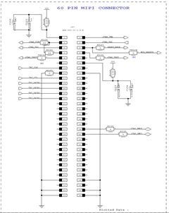

I have a board with TDA4VH-Q1. My SW team shall be using different tools such as (LA-3254, XDS560V2 etc.). I have JTAG, EMU (EMU0 and EMU1) and four trace signals to be be provided. Now I see there are different headers with many options. I can see that JTAG and EMU pins can be given access using Compact TI 20-pin header and standard ARM 20 pin header. But I do not see option to include trace signals.
There are also converters from 20IDC to MIPI 60 pins but I don't see the trace signals signals on 20 pin connector to be routed to 60-pin connectors.
What are the least amount of connectors I can have on the target board to include JTAG, four trace signals and two EMU signals which are compatible to most of the tools I am going to use or with off the shelf adapters available?
