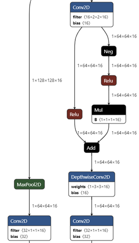

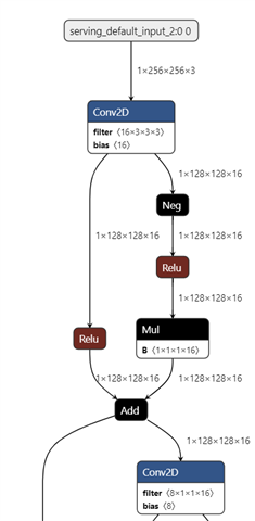

Our tflite model looks like:
there is no other special operations in our model.
Moreover, what's the meaning of "there are 16 subgraphs, 93 nodes delegated out of 493 nodes." This sentence appeared in our log as well. Does this sentence mean that only 93 nodes are offloaded to C7x-MMA?

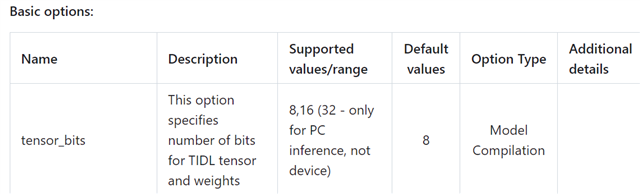

We also found that we can set tensor_bits to 32 when we did the inference on EVM. That is weird. Could you clarify this circumstance?

    Which SDK version are you on? There were several features added in 9.1 that may help for some of the layers that were not offloaded. Your understanding of the "93 of 493 nodes delegated" is correct -- only those 93 layers are running on the accelerator and the rest are on the CPU. I would expect performance to be quite slow here. 16 is the maximum number of subgraphs, so while more layers could be run on the accelerator, the topology of the supported/unsupported nodes
    The tensor_bits option is only used for compilation, I believe. Inference on the EVM will ignore this option and focus on what the compiled binaries contain.

    Could you list the operators supported by the 9.1 SDK over the 8.6 SDK? My model is relatively simple, only includes Conv2d, Relu, DepthwiseConv2d, Neg, Add, Mul, Maxpool2d operators, I don't know why only 93 layers are offloaded.

     If I understand correctly, when tensor bits is set to 32,
    I believe this only works for emulation mode on the PC, and that the compiled artifacts will likely cause a hang on the target processor.
    You can compare between the supported ops page from 8.6 release and current:
    There are additions like gather, slice, more dimensions for Mat, Add, Sub, etc., kernel/stride dimensions for pooling layers, etc. as well as bugfixes across the SW stack.
