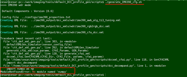

Hi Brijesh,
error occurred
execute: ./generate_IMX390_cfg.sh, python3 ctt_def_xml_gen.py ../configs/imx390_properties.txt
Cesar
Hi Cesar,
I think the python is not installed properly in this case, or numPy module is not installed correctly. Can you please method suggested on below link?
python - Error "Import Error: No module named numpy" on Windows - Stack Overflow
Brijesh
