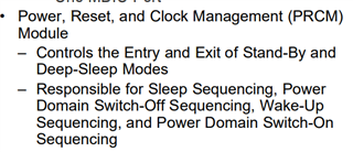

May I heva question about AMIC110 sleepmode?
In DS there are some sleepmode.
However in this topic says "Baremetal/RTOS doesn't support any low power mode."
https://e2e.ti.com/support/processors-group/processors/f/processors-forum/1311665/amic110-amic110-wake-up-capacity
Is this mean AMIC110 could not use Low power mode by hardware?
Or means there is no sample program but we could use some power mode by reading the TRM and manipulating the associated registers?
GR
  • Correct, there is no software for power management in bare metal/RTOS and in general we have stopped supporting  TI RTOS across all of our product families.
