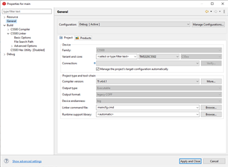

  • Hi Ming, Here's my General project configuration.
    I noticed my maincfg.cmd was updated by CCS (xdctools?) when I opened my v2.0 main.cdb file.  It saved my main.cdb to main.cdb.Tue_Feb_06_16.45.29_2024 and created the following files:
    • main.tcf
    • main.cfg
    • maincfg.h55
    • maincfg.s55
    • maincfg_c.c
