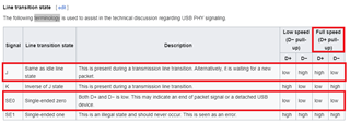

    The Dp/Dn lines can be low together (SE0 USB bus reset) but cannot be high together. This is an illegal condition.

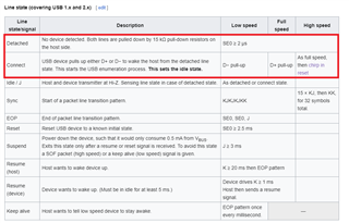

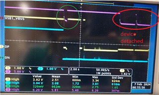

    I guess TDA4 USB1 does not detect USB HOST "detached"  "correctly", and this should be the "root cause", so the problem caused USB1 attach fail for next time (illegal condition). I found something strange in video, capture picture as below.
    We can observer VBUS drop down about 0.4 sec, and data line still keep in "J state" (D+ pull high, D- pull low) before device "real detached". I think it should be some conflict in USB line state. I think data line should be in SE0 state first, and then cut off VBUS for USB detached.
    Ref. https://en.wikipedia.org/wiki/USB_communications

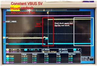

  • Hi Gibbs
    Because no USB error detection that we just suppose Dn high is root cause by below some tests.
    1-VBUS_USB1 keeps constant 5V in Hub 5V power trace without drop happen. But MDD fail still happen again. So VBUS item may not issue cause. Strangely USB bus will lock Dp high & Dn low without data communication. It seems new fail case different to original Dp/Dn low issue.
     2-Changing Hub to self-power in correct USB2.0 idle state Dp high/Dn low(SE0), issue not happen any more.
    *So Dn/Dp both high illegal condition maybe issue root cause.

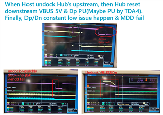

  • Hi, Gibbs & Shreyas
    Please confirm de-attach waveform(Hub's VBUS off & Dp PU in short time), it seems really impact to TDA4 USB1 idle status.

    So far we could converge TDA4’s USB controller crash in hub’s first reset period.
    Next speculation and proof Dp/Dn both high were pulled up by Hub’s second reset period.
  • As per our discussion, 'the Hub changed to self-powered, and the issue does not happen anymore indicating that the Vbus is always enabled with the self-powered Hub, however, the Vbus logic is not being detected correctly by the hub when its not self-powered. It indicates that the Hub may have the likely issue to be fixed to get this working.
  • Hi Shreyas
    Self-power will always keeps host OTG 5V in upstream port(Hub circuit design). So Hub will not repeatedly execute to reset VBUS1/Dp/Dn in downstream port during host disconnet.
    Yesterday I had shared some benchmark tests to Gibbs. Please discuss with him.
    Thanks.
  • Yes, that is the issue where the Hub in self-powered mode always keeps the Vbus on; whereas in normal operation, the host must implement the Vbus reset, and detect the connect/disconnect of the USB device which is not happening in this case. So, probably the Hub's internal logic must be looked into.
