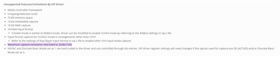

We are using am5728 SOC based custom board. We wanted to know the maximum resolution that is supported by the VIP module for video mode. We have a custom camera that supports upto 5M resolution.
Also is VPE responsible for limiting the maximum resolution (5M in our case) input that will be displayed on the LCD?
