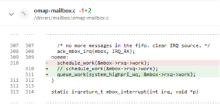

    I've been looking into the kernel sources, and neither the mbox driver, nor the rpmsg driver seem to create a dedicated kworker thread. The mbox driver uses "schedule_work" in the interrupt function (https://git.kernel.org/pub/scm/linux/kernel/git/stable/linux.git/tree/drivers/mailbox/omap-mailbox.c?h=v6.1.78#n310), which queues work for such a general kworker thread. The rpmsg_char implementation doesn't seem to use kworkers at all, and just waits for data in a queue during the read. (https://git.kernel.org/pub/scm/linux/kernel/git/stable/linux.git/tree/drivers/rpmsg/rpmsg_char.c?h=v6.1.78#n191). So we still think our problem is the (general purpose) kworker, which is triggered by the mbox interrupt.
  • We have experimented with this small patch.
    So we explicitly request a high priority worker, which runs at sched_other and niceness -20. This seems to run much better. We still have to run some longer running tests, but we experimented with stress-ng. Even running the CPU cores on 100% with the (non-rt) stress-ng tasks, we did not have problems.
    If the mbox driver is to be part of a communication chain, I think it should use these higher priority queues. Do you think it would be possible to make such a change upstream?
    I don't think this can be accepted to upstream, it will mostly be a no-go, since there is no valid/proper justification for such a change. Every driver consumer can make the same arguments, and it will all be the same contention.
    If the solution works for you, you can make the change on your system. The only other solution I can think of it to use a dedicated workqueue (which is probably where the kernel was) before the consolidation, this would again be an out-of-tree solution.

  • We have created a kernel patch that changes the omap mailbox driver to use dedicated kthread workers, which are set to a fifo priority. We're still testing, but this seems to be sufficient to protect the real-time communication from any normal Linux tasks.
