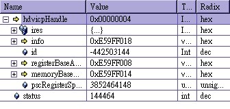

I think it is a bug in the following tracing:
HDVICPSYNC_start
   --> VICP_register(vicp=VICP_HDVICP0=4/*VICP_ResourceType,a scalar*/,...)
          g_handle = (IRES_HDVICP_Handle) resource (=VICP_HDVICP0);
          g_fnPtr = HDVICPSYNC_done;
INT triggers Host_int_handler
   --> HDVICPSYNC_done(hdvicpHandle=g_handle(=VICP_HDVICP0))
          if (hdvicpHandle->id == IRES_HDVICP_ID_0) { //<-------- FAIL !!!
              vicp = VICP_HDVICP0;
          else {
              return (HDVICPSYNC_ENORESOURCE);

  • What device are you running your app on ?
    Could you also tell me what the contents of your hdvicpHandle are ? You can either step through the code for that, or enable trace that would print out what id has been granted to your algorithm.

    I run the app on a DM365-297MHz.
    As the trace (done by steps) I posted, the value of hdvicpHandle is 4(VICP_HDVICP0) to HDVICPSYNC_done().
    hdvicpHandle(=4)->id is not guaranteed to be a valid value
