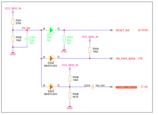

Hello TI team,
We are using AM625, I need to configure Watchdog.
After 60, applying below command, board is getting rebooted properly...
cat /dev/watchdogX
But we are expecting a pulse on pin A4 (WKUP_TIMER_IO1) on watchdog timeout reboot.
For that i'm configuring pin mux as below in dts.
AM62X_IOPAD(0x030, PIN_OUTPUT, 1)
But it's getting error in booting, it' getting rebooted itself, logs given below.

    when i probed on the pin pin(A4)WKUP_TIMER_IO1,  got pulse on reboot.
    But board is not able to boot completely, before booting process complete, it's getting rebooted again and again.
    Please guide us on the same.
    Thanks and regards,
    Ishan
  • Hello Ishan,
    Can you please confirm what you are observing in each of these cases?
    CASE 1: neither main_rti1 nor watchdog_pins_default are in the Linux devicetree file
    CASE 2: main_rti1 is in the Linux devicetree file, but watchdog_pins_default is NOT in the Linux devicetree file (i.e., we do not pin out a watchdog signal)
    CASE 3: both main_rti1 and watchdog_pins_default are in the Linux devicetree file
    Please share the schematic of the watchdog signal (if you are using custom hardware)
    Nick

    Yes we are using custom HW, watchdog schematic given below.
    Please guide on the same,

     Device tree changes
    I just want to highlight, I have shared the dts changes earlier, In that i'm using pin (A4) WKUP_TIMER_IO1 , which should be belongs to wkup domain of the SOC. And assigning this pinmux to the node main_rti1, which should be belongs to main domain of the SOC.
    I have done like that because, i didn't found node wkup_rti1. (i found wkup_rti0 but, we are using pin function WKUP_TIMER_IO1).
    Should this approach work ?
    reference from TRM (page no. 1765)
    Is that means, watchdog timout pulse will be generated on RESETSTATz pin ?  and which is the non-maskable interrupt pin ?
    Note : didn't found any statement in TRM which defines watchdog timeout pulse can be generated on GPIO.
    We need to define the pin on which we can the watchdog timeout pulse ?
    Please guide us for the same.

  • Hello Ishan,
    Ok, let's start from the beginning. Where did you see documentation that a pulse can be generated on a pin upon watchdog timeout?
    I do not see that documentation anywhere in the TRM or datasheet, and it is not a feature that the Linux developer has heard of either.
    WKUP_TIMER is not associated with the RTI / watchdog timer. It's associated with.. well, the timers in the wakeup domain. So my suspicion is that this feature does not actually exist.
    Nick
