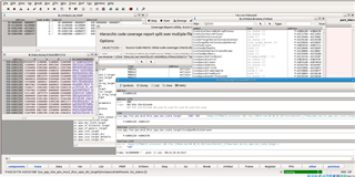

We need to understand ddr memory utilization by different stack frames [sw modules] mipi, isp etc. Seems I am unable to do proper configurations in Lauterbach. Request your support for getting this done.
so we have memory map of rtos/dsp cores and want to see how much getting used out of it for our application. currently trying to log from mcu2_0 core. once it is done then will check for A72 side.
Expectation:
  1. Memory Utilization of each task and sub nodes in graph
  2. CPU utilization , HW Peripheral Utilization in terms of Accelerators etc.
SDK Rtos Ver: 08.06.01.03
QNX+RTOS Mode
Profile: Debug
PRACTICE Script:
