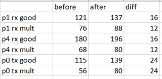

  • Hi Tanmay,
    I have configured below but still it is not working.
    bridge link set dev eth1 mcast_flood on
    bridge link set dev eth4 mcast_flood on
    Network topology is
    PC1 <======> ETH1 port  ((( TI Hardware))) ETH4 Port <=======> PC2
    Actually I am running cyclonedds in PC1 and PC2.  when i connect without TI switch cyclonedds messages working between PC1 and PC2.
  • HI Pavan,
    Can you see any multicast packets being received on the interface on TDA4VM. You can run "tcpdump -i eth1/eth4" to see the packets on eth1 or eth4.
    If you are receiving the packets, but they are not being forwarded to the other port, there might be additional configuration required on linux on the TDA4VM for cyclonedds which I am not aware of.
    Tanmay

  • Hi Pavan,
    Can you also add the following command to the configuration steps and see if you are able to receive multicast traffic:
    bridge vlan add dev br0 vid 1 self
    If not, then can you print the ALE table using the attached code:

  • Hi Pawan,
    From the logs the ALE is configured correctly and the multicast on which you are transmitting should be received on host port.
    Can you capture the CPSW statistic (using "ethtool -S eth1/eth4", on which you are receiving the multicast traffic.) twice around 10 second apart while the multicast traffic is being sent.
    This would help us see if there are any drops in the hardware. It would be even better if we can find out how many multicast packets were actually sent during this time.
    Tanmay
  • Hi Tanmay,
    Please find below and configuration followed same as above.
    Here i have attached completed logs.

    root@j721e-evm:~# ethtool -S eth1
    NIC statistics:
    p0_rx_good_frames: 169
    p0_rx_broadcast_frames: 54
    p0_rx_multicast_frames: 115
    p0_rx_crc_errors: 0
    p0_rx_oversized_frames: 0
    p0_rx_undersized_frames: 0
    p0_ale_drop: 12
    p0_ale_overrun_drop: 0
    p0_rx_octets: 31787
    p0_tx_good_frames: 115
    p0_tx_broadcast_frames: 59
    p0_tx_multicast_frames: 56
    p0_tx_octets: 18269
    p0_tx_64B_frames: 9
    p0_tx_65_to_127B_frames: 138
    p0_tx_128_to_255B_frames: 73
    p0_tx_256_to_511B_frames: 64
    p0_tx_512_to_1023B_frames: 0
    p0_tx_1024B_frames: 0
    p0_net_octets: 50056
    p0_rx_bottom_fifo_drop: 0
    p0_rx_port_mask_drop: 12
    p0_rx_top_fifo_drop: 0
    p0_ale_rate_limit_drop: 0
    p0_ale_vid_ingress_drop: 33
    p0_ale_da_eq_sa_drop: 0
    p0_ale_block_drop: 0
    p0_ale_secure_drop: 0
    p0_ale_auth_drop: 0
    p0_ale_unknown_ucast: 0
    p0_ale_unknown_ucast_bytes: 0
    p0_ale_unknown_mcast: 0
    p0_ale_unknown_mcast_bytes: 0
    p0_ale_unknown_bcast: 0
    p0_ale_unknown_bcast_bytes: 0
    p0_ale_pol_match: 0
    p0_ale_pol_match_red: 0
    p0_ale_pol_match_yellow: 0
    p0_ale_mcast_sa_drop: 0
    p0_ale_dual_vlan_drop: 0
    p0_ale_len_err_drop: 0
    p0_ale_ip_next_hdr_drop: 0
    p0_ale_ipv4_frag_drop: 0
    p0_tx_mem_protect_err: 0
    p0_tx_pri0: 115
    p0_tx_pri1: 0
    p0_tx_pri2: 0
    p0_tx_pri3: 0
    p0_tx_pri4: 0
    p0_tx_pri5: 0
    p0_tx_pri6: 0
    p0_tx_pri7: 0
    p0_tx_pri0_bcnt: 18105
    p0_tx_pri1_bcnt: 0
    p0_tx_pri2_bcnt: 0
    p0_tx_pri3_bcnt: 0
    p0_tx_pri4_bcnt: 0
    p0_tx_pri5_bcnt: 0
    p0_tx_pri6_bcnt: 0
    p0_tx_pri7_bcnt: 0
    p0_tx_pri0_drop: 0
    p0_tx_pri1_drop: 0
    p0_tx_pri2_drop: 0
    p0_tx_pri3_drop: 0
    p0_tx_pri4_drop: 0
    p0_tx_pri5_drop: 0
    p0_tx_pri6_drop: 0
    p0_tx_pri7_drop: 0
    p0_tx_pri0_drop_bcnt: 0
    p0_tx_pri1_drop_bcnt: 0
    p0_tx_pri2_drop_bcnt: 0
    p0_tx_pri3_drop_bcnt: 0
    p0_tx_pri4_drop_bcnt: 0
    p0_tx_pri5_drop_bcnt: 0
    p0_tx_pri6_drop_bcnt: 0
    p0_tx_pri7_drop_bcnt: 0
    rx_good_frames: 121
    rx_broadcast_frames: 20
    rx_multicast_frames: 76
    rx_pause_frames: 0
    rx_crc_errors: 0
    rx_align_code_errors: 0
    rx_jabber_frames: 0
    rx_fragments: 0
    ale_drop: 63
    ale_overrun_drop: 0
    rx_octets: 16480

    root@j721e-evm:~# # after 10 sec
    root@j721e-evm:~#
    NIC statistics:
    p0_rx_good_frames: 175
    p0_rx_broadcast_frames: 58
    p0_rx_multicast_frames: 117
    p0_rx_crc_errors: 0
    p0_ale_drop: 12
    p0_rx_octets: 33283
    p0_tx_good_frames: 139
    p0_tx_multicast_frames: 80
    p0_tx_octets: 26916
    p0_tx_64B_frames: 9
    p0_tx_65_to_127B_frames: 145
    p0_tx_128_to_255B_frames: 76
    p0_tx_256_to_511B_frames: 84
    p0_net_octets: 60199
    p0_ale_auth_drop: 0
    p0_ale_pol_match: 0
    p0_tx_pri0: 139
    p0_tx_pri1: 0
    p0_tx_pri2: 0
    p0_tx_pri3: 0
    p0_tx_pri4: 0
    p0_tx_pri5: 0
    p0_tx_pri6: 0
    p0_tx_pri7: 0
    p0_tx_pri0_bcnt: 26656
    p0_tx_pri1_bcnt: 0
    p0_tx_pri2_bcnt: 0
    p0_tx_pri3_bcnt: 0
    p0_tx_pri4_bcnt: 0
    p0_tx_pri5_bcnt: 0
    p0_tx_pri6_bcnt: 0
    p0_tx_pri7_bcnt: 0
    p0_tx_pri0_drop: 0
    p0_tx_pri1_drop: 0
    p0_tx_pri2_drop: 0
    p0_tx_pri3_drop: 0
    p0_tx_pri4_drop: 0
    p0_tx_pri5_drop: 0
    p0_tx_pri6_drop: 0
    p0_tx_pri7_drop: 0
    rx_good_frames: 137
    rx_multicast_frames: 88
    rx_pause_frames: 0
    rx_crc_errors: 0
    rx_jabber_frames: 0
    rx_fragments: 0
    ale_drop: 63
    ale_overrun_drop: 0
    rx_octets: 20754
    tx_good_frames: 111
    tx_broadcast_frames: 28
    tx_multicast_frames: 55
    tx_pause_frames: 0
    tx_deferred_frames: 0
    tx_collision_frames: 0
    tx_single_coll_frames: 0
    tx_mult_coll_frames: 0
    tx_excessive_collisions: 0
    tx_late_collisions: 0
    rx_ipg_error: 0
    tx_carrier_sense_errors: 0
    tx_octets: 18133
    tx_64B_frames: 34
    tx_65_to_127B_frames: 114
    tx_128_to_255B_frames: 65
    tx_256_to_511B_frames: 35
    tx_1024B_frames: 0
    net_octets: 38887
    rx_port_mask_drop: 63
    rx_top_fifo_drop: 0
    ale_vid_ingress_drop: 12
    ale_block_drop: 0
    ale_secure_drop: 0
    ale_auth_drop: 0
    ale_unknown_mcast: 63
    ale_unknown_mcast_bytes: 10484
    ale_unknown_bcast: 14
    ale_unknown_bcast_bytes: 896
    ale_pol_match: 0
    ale_len_err_drop: 0
    iet_rx_assembly_err: 0
    iet_rx_assembly_ok: 0
    iet_rx_smd_err: 2
    iet_rx_frag: 0
    iet_tx_hold: 0
    iet_tx_frag: 0
    tx_pri0: 111
    tx_pri1: 0
    tx_pri2: 0
    tx_pri3: 0
    tx_pri4: 0
    tx_pri5: 0
    tx_pri6: 0
    tx_pri7: 0
    tx_pri0_bcnt: 18045
    tx_pri1_bcnt: 0
    tx_pri2_bcnt: 0
    tx_pri3_bcnt: 0
    tx_pri4_bcnt: 0
    tx_pri5_bcnt: 0
    tx_pri6_bcnt: 0
    tx_pri7_bcnt: 0
    tx_pri0_drop: 0
    tx_pri1_drop: 0
    tx_pri2_drop: 0
    tx_pri3_drop: 0
    tx_pri4_drop: 0
    tx_pri5_drop: 0
    tx_pri6_drop: 0
    tx_pri7_drop: 0
    root@j721e-evm:~#
    root@j721e-evm:~#
    root@j721e-evm:~#
    root@j721e-evm:~# ethtool -S eth4
    NIC statistics:
    p0_rx_crc_errors: 0
    p0_ale_drop: 12
    p0_rx_octets: 33283
    p0_tx_octets: 26916
    p0_tx_64B_frames: 9
    p0_ale_auth_drop: 0
    p0_ale_pol_match: 0
    p0_tx_pri0: 139
    p0_tx_pri1: 0
    p0_tx_pri2: 0
    p0_tx_pri3: 0
    p0_tx_pri4: 0
    p0_tx_pri5: 0
    p0_tx_pri6: 0
    p0_tx_pri7: 0
    p0_tx_pri1_bcnt: 0
    p0_tx_pri2_bcnt: 0
    p0_tx_pri3_bcnt: 0
    p0_tx_pri4_bcnt: 0
    p0_tx_pri5_bcnt: 0
    p0_tx_pri6_bcnt: 0
    p0_tx_pri7_bcnt: 0
    p0_tx_pri0_drop: 0
    p0_tx_pri1_drop: 0
    p0_tx_pri2_drop: 0
    p0_tx_pri3_drop: 0
    p0_tx_pri4_drop: 0
    p0_tx_pri5_drop: 0
    p0_tx_pri6_drop: 0
    p0_tx_pri7_drop: 0
    rx_good_frames: 196
    rx_broadcast_frames: 88
    rx_multicast_frames: 80
    rx_pause_frames: 0
    rx_crc_errors: 0
    rx_jabber_frames: 0
    rx_fragments: 0
    ale_drop: 74
    ale_overrun_drop: 0
    rx_octets: 28184
    tx_good_frames: 112
    tx_broadcast_frames: 27
    tx_pause_frames: 0
    rx_ipg_error: 0
    tx_octets: 18592
    tx_64B_frames: 54
    tx_65_to_127B_frames: 156
    tx_128_to_255B_frames: 48
    tx_256_to_511B_frames: 50
    tx_1024B_frames: 0
    net_octets: 46776
    rx_port_mask_drop: 74
    rx_top_fifo_drop: 0
    ale_block_drop: 0
    ale_secure_drop: 0
    ale_auth_drop: 0
    ale_unknown_mcast: 38
    ale_unknown_mcast_bytes: 6008
    ale_unknown_bcast: 85
    ale_unknown_bcast_bytes: 9498
    ale_pol_match: 0
    ale_len_err_drop: 0
    iet_rx_smd_err: 1
    iet_rx_frag: 0
    iet_tx_hold: 0
    iet_tx_frag: 0
    tx_pri0: 112
    tx_pri1: 0
    tx_pri2: 0
    tx_pri3: 0
    tx_pri4: 0
    tx_pri5: 0
    tx_pri6: 0
    tx_pri7: 0
    tx_pri0_bcnt: 18512
    tx_pri1_bcnt: 0
    tx_pri2_bcnt: 0
    tx_pri3_bcnt: 0
    tx_pri4_bcnt: 0
    tx_pri5_bcnt: 0
    tx_pri6_bcnt: 0
    tx_pri7_bcnt: 0
    tx_pri0_drop: 0
    tx_pri1_drop: 0
    tx_pri2_drop: 0
    tx_pri3_drop: 0
    tx_pri4_drop: 0
    tx_pri5_drop: 0
    tx_pri6_drop: 0
    tx_pri7_drop: 0
    root@j721e-evm:~#
    root@j721e-evm:~#
    root@j721e-evm:~#
    root@j721e-evm:~#
    NIC statistics:
    p0_rx_good_frames: 176
    p0_rx_broadcast_frames: 59
    p0_rx_crc_errors: 0
    p0_ale_drop: 12
    p0_rx_octets: 33620
    p0_tx_good_frames: 167
    p0_tx_broadcast_frames: 61
    p0_tx_multicast_frames: 106
    p0_tx_octets: 35436
    p0_tx_64B_frames: 9
    p0_tx_65_to_127B_frames: 154
    p0_tx_128_to_255B_frames: 79
    p0_tx_256_to_511B_frames: 101
    p0_net_octets: 69056
    p0_ale_auth_drop: 0
    p0_ale_pol_match: 0
    p0_tx_pri0: 167
    p0_tx_pri1: 0
    p0_tx_pri2: 0
    p0_tx_pri3: 0
    p0_tx_pri4: 0
    p0_tx_pri5: 0
    p0_tx_pri6: 0
    p0_tx_pri7: 0
    p0_tx_pri0_bcnt: 35064
    p0_tx_pri1_bcnt: 0
    p0_tx_pri2_bcnt: 0
    p0_tx_pri3_bcnt: 0
    p0_tx_pri4_bcnt: 0
    p0_tx_pri5_bcnt: 0
    p0_tx_pri6_bcnt: 0
    p0_tx_pri7_bcnt: 0
    p0_tx_pri0_drop: 0
    p0_tx_pri1_drop: 0
    p0_tx_pri2_drop: 0
    p0_tx_pri3_drop: 0
    p0_tx_pri4_drop: 0
    p0_tx_pri5_drop: 0
    p0_tx_pri6_drop: 0
    p0_tx_pri7_drop: 0
    rx_good_frames: 151
    rx_multicast_frames: 102
    rx_pause_frames: 0
    rx_crc_errors: 0
    rx_jabber_frames: 0
    rx_fragments: 0
    ale_drop: 63
    ale_overrun_drop: 0
    rx_octets: 24824
    tx_good_frames: 114
    tx_broadcast_frames: 31
    tx_pause_frames: 0
    rx_ipg_error: 0
    tx_octets: 19011
    tx_64B_frames: 38
    tx_65_to_127B_frames: 115
    tx_128_to_255B_frames: 67
    tx_256_to_511B_frames: 45
    tx_1024B_frames: 0
    net_octets: 43835
    rx_top_fifo_drop: 0
    ale_block_drop: 0
    ale_secure_drop: 0
    ale_auth_drop: 0
    ale_pol_match: 0
    ale_len_err_drop: 0
    iet_rx_smd_err: 2
    iet_rx_frag: 0
    iet_tx_hold: 0
    iet_tx_frag: 0
    tx_pri0: 114
    tx_pri1: 0
    tx_pri2: 0
    tx_pri3: 0
    tx_pri4: 0
    tx_pri5: 0
    tx_pri6: 0
    tx_pri7: 0
    tx_pri0_bcnt: 18923
    tx_pri1_bcnt: 0
    tx_pri2_bcnt: 0
    tx_pri3_bcnt: 0
    tx_pri4_bcnt: 0
    tx_pri5_bcnt: 0
    tx_pri6_bcnt: 0
    tx_pri7_bcnt: 0
    tx_pri0_drop: 0
    tx_pri1_drop: 0
    tx_pri2_drop: 0
    tx_pri3_drop: 0
    tx_pri4_drop: 0
    tx_pri5_drop: 0
    tx_pri6_drop: 0
    tx_pri7_drop: 0
    root@j721e-evm:~#
    root@j721e-evm:~#
    root@j721e-evm:~#
    NIC statistics:
    p0_rx_good_frames: 177
    p0_rx_broadcast_frames: 60
    p0_rx_crc_errors: 0
    p0_ale_drop: 12
    p0_rx_octets: 33957
    p0_tx_good_frames: 168
    p0_tx_multicast_frames: 107
    p0_tx_octets: 35914
    p0_tx_64B_frames: 9
    p0_tx_256_to_511B_frames: 103
    p0_net_octets: 69871
    p0_ale_auth_drop: 0
    p0_ale_pol_match: 0
    p0_tx_pri0: 168
    p0_tx_pri1: 0
    p0_tx_pri2: 0
    p0_tx_pri3: 0
    p0_tx_pri4: 0
    p0_tx_pri5: 0
    p0_tx_pri6: 0
    p0_tx_pri7: 0
    p0_tx_pri0_bcnt: 35538
    p0_tx_pri1_bcnt: 0
    p0_tx_pri2_bcnt: 0
    p0_tx_pri3_bcnt: 0
    p0_tx_pri4_bcnt: 0
    p0_tx_pri5_bcnt: 0
    p0_tx_pri6_bcnt: 0
    p0_tx_pri7_bcnt: 0
    p0_tx_pri0_drop: 0
    p0_tx_pri1_drop: 0
    p0_tx_pri2_drop: 0
    p0_tx_pri3_drop: 0
    p0_tx_pri4_drop: 0
    p0_tx_pri5_drop: 0
    p0_tx_pri6_drop: 0
    p0_tx_pri7_drop: 0
    rx_good_frames: 210
    rx_broadcast_frames: 90
    rx_multicast_frames: 92
    rx_pause_frames: 0
    rx_crc_errors: 0
    rx_jabber_frames: 0
    rx_fragments: 0
    ale_drop: 74
    ale_overrun_drop: 0
    rx_octets: 32522
    tx_good_frames: 113
    tx_pause_frames: 0
    rx_ipg_error: 0
    tx_octets: 18929
    tx_64B_frames: 58
    tx_128_to_255B_frames: 49
    tx_256_to_511B_frames: 60
    tx_1024B_frames: 0
    net_octets: 51451
    rx_top_fifo_drop: 0
    ale_block_drop: 0
    ale_secure_drop: 0
    ale_auth_drop: 0
    ale_pol_match: 0
    ale_len_err_drop: 0
    iet_rx_smd_err: 1
    iet_rx_frag: 0
    iet_tx_hold: 0
    iet_tx_frag: 0
    tx_pri0: 113
    tx_pri1: 0
    tx_pri2: 0
    tx_pri3: 0
    tx_pri4: 0
    tx_pri5: 0
    tx_pri6: 0
    tx_pri7: 0
    tx_pri0_bcnt: 18849
    tx_pri1_bcnt: 0
    tx_pri2_bcnt: 0
    tx_pri3_bcnt: 0
    tx_pri4_bcnt: 0
    tx_pri5_bcnt: 0
    tx_pri6_bcnt: 0
    tx_pri7_bcnt: 0
    tx_pri0_drop: 0
    tx_pri1_drop: 0
    tx_pri2_drop: 0
    tx_pri3_drop: 0
    tx_pri4_drop: 0
    tx_pri5_drop: 0
    tx_pri6_drop: 0
    tx_pri7_drop: 0
    root@j721e-evm:~#
    root@j721e-evm:~#
    root@j721e-evm:~#
    root@j721e-evm:~#
    root@j721e-evm:~#
    NIC statistics:
    p0_rx_good_frames: 181
    p0_rx_broadcast_frames: 62
    p0_rx_multicast_frames: 119
    p0_rx_crc_errors: 0
    p0_ale_drop: 12
    p0_rx_octets: 34779
    p0_tx_good_frames: 198
    p0_tx_multicast_frames: 137
    p0_tx_octets: 46930
    p0_tx_64B_frames: 9
    p0_tx_65_to_127B_frames: 164
    p0_tx_256_to_511B_frames: 127
    p0_net_octets: 81709
    p0_ale_auth_drop: 0
    p0_ale_pol_match: 0
    p0_tx_pri0: 198
    p0_tx_pri1: 0
    p0_tx_pri2: 0
    p0_tx_pri3: 0
    p0_tx_pri4: 0
    p0_tx_pri5: 0
    p0_tx_pri6: 0
    p0_tx_pri7: 0
    p0_tx_pri0_bcnt: 46434
    p0_tx_pri1_bcnt: 0
    p0_tx_pri2_bcnt: 0
    p0_tx_pri3_bcnt: 0
    p0_tx_pri4_bcnt: 0
    p0_tx_pri5_bcnt: 0
    p0_tx_pri6_bcnt: 0
    p0_tx_pri7_bcnt: 0
    p0_tx_pri0_drop: 0
    p0_tx_pri1_drop: 0
    p0_tx_pri2_drop: 0
    p0_tx_pri3_drop: 0
    p0_tx_pri4_drop: 0
    p0_tx_pri5_drop: 0
    p0_tx_pri6_drop: 0
    p0_tx_pri7_drop: 0
    rx_good_frames: 225
    rx_multicast_frames: 107
    rx_pause_frames: 0
    rx_crc_errors: 0
    rx_jabber_frames: 0
    rx_fragments: 0
    ale_drop: 74
    ale_overrun_drop: 0
    rx_octets: 37948
    tx_good_frames: 115
    tx_broadcast_frames: 29
    tx_multicast_frames: 57
    tx_pause_frames: 0
    rx_ipg_error: 0
    tx_octets: 19340
    tx_64B_frames: 62
    tx_65_to_127B_frames: 157
    tx_256_to_511B_frames: 72
    tx_1024B_frames: 0
    net_octets: 57288
    rx_top_fifo_drop: 0

    From the stats, we can see the following :
    here p0 is the host port, p1 is the external port corresponding to eth1, p4 is the external port corresponding to eth4. You have received 12 multicast packets each on eth1 and eth4 and p0 has transmitted these 24 multicast packets to the A72. Hence, there are no drops in the hardware.
    This means that somehow linux network stack is not picking up the multicast packets. I am not sure why this could be happening.
    Just checking if you have checked the traffic on br0 interface and if you are able to see the multicast on this interface.
    If you know the  IP address for the multicast traffic, you can add the address to the mdb database as follows:
    bridge mdb add dev br0 port eth1 grp 239.1.1.1 permanent
    Do this for both eth1 and eth4.
