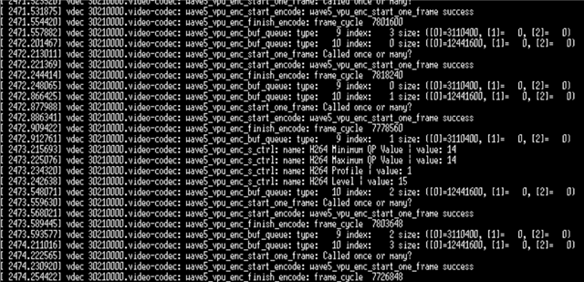

    Thanks very much for your support on this issue, I appreciate you patching this in! I have noted something interesting on dynamic bitstream, the program above does appear to correctly change the s_ctrls in the driver (as shown in kernel debug below), but these updated controls are not used by the VPU instance and therefore the output stream bitrate does not change.
    When you say that "dynamic bitrate should also be supported", do you mean that the API currently supports it or that the upcoming patch will add this support?
    If the current driver version does support dynamic bitrate changes, do I just need to send some kind of event to the driver to tell it to refresh the VPU instance? Or will this support be added in the upcoming patch?

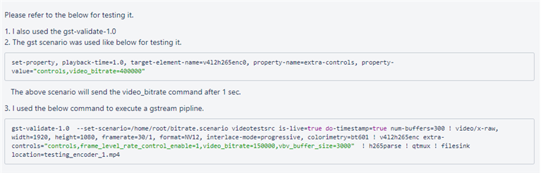

  • Hi Matt,
    Please find the two patches for I-frame request and bitrate.
    https://e2e.ti.com/cfs-file/__key/communityserver-discussions-components-files/791/v0_2D00_0001_2D00_media_2D00_chips_2D00_media_2D00_wave5_2D00_Support_2D00_a_2D00_force_2D00_key_2D00_frame.patchhttps://e2e.ti.com/cfs-file/__key/communityserver-discussions-components-files/791/v0_2D00_0001_2D00_media_2D00_chips_2D00_media_2D00_wave5_2D00_Support_2D00_to_2D00_change_2D00_a_2D00_bitrate.patch
    After applying the above patch, if you issue v4l2-ctl -d 1 --list-ctrls-menu on a console, then you can see this "force_key_frame 0x009909e5 (button) : value=0 flags=write-only, execute-on-write" to support the request of I-frame.
    For bitrate testing:
    I assume, you should be able to change the QP value in similar fashion. These would be part of the 10.x SDK release.
    Feel free to try them on your end and see if it helps.
