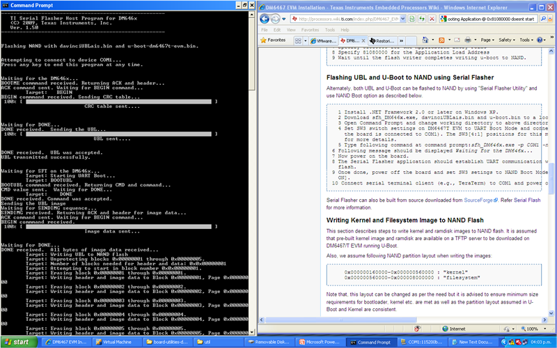

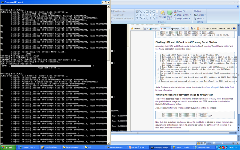

If you like, you can create your own uboot.bin in your linux machine, but im gonna do this even more easy, follow the steps about Flashing UBL and U-Boot to NAND using Serial Flasher , in the step 2.- Download sfh_DM646x.exe, davinciUBLais.bin and u-boot.bin to a local folder, let's say "C:\tmp", if you dont have the u-boot.bin file, you must replace it from the one wich came with the CD called u-boot-dm6467t-evm.bin or the one wich was downloaded from the previous link. When you get to the step in when you must type in the windows command prompt, the instruction will be a litle different since you have replaced one file, it will be like this "sfh_DM646x.exe -p COM1 -nandflash  -UBLStartAddr 0x20 davinciUBLais.bin u-boot-dm6467t-evm.bin". Im gonna out some images, of how it will look on youre computer, im sorry about not getting into details, but all the steps are in the link provided at the start, im just proposing an alternate way of doing things.
in the last image it dislpays an error, i believe thats because linux kernel image its missing, so you must follow the next steps on the wiki to recovering it, but at least you can communicate with the board once again, hope this its useful.

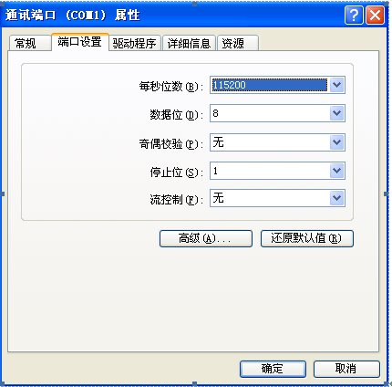

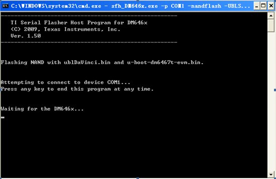

  • hello , I have done"sfh_DM646x.exe -p COM1 -nandflash  -UBLStartAddr 0x20 davinciUBLais.bin u-boot-dm6467t-evm.bin",but stop "Waiting for the DM646x...". and I set SW3[0-7] "00010000" and S1 "HH",where I do wrong?Thanks...
  • Are you sure you are connected to the COM1 in your computer?? if not, you only need to change the COM parameter in the windows command prompt like this
    "sfh_DM646x.exe -p COM? -nandflash  -UBLStartAddr 0x20 davinciUBLais.bin u-boot-dm6467t-evm.bin",
    also, if you're using a serial to USB converter, windows give you the COM of the ports in the device manager
