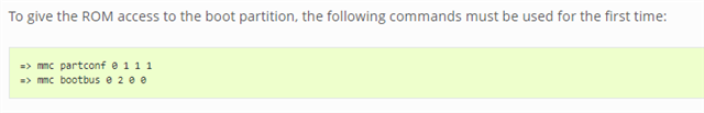

  • Hi Robert,
    By default, the DFU_ALT_INFO_EMMC variable is set to flash rootfs in partition no. 1 of eMMC UDA ("rootfs part 0 1"). However, you have partitioned the eMMC UDA with two partitions with the second partition long enough to accomodate the rootfs filesystem.
    So, you would want to update the DFU_ALT_INFO_EMMC to flash rootfs to 2nd partition ("rootfs part 0 2"). The updated DFU_ALT_INFO_EMMC looks like:
    => setenv dfu_alt_info_emmc 'rawemmc raw 0 0x800000 mmcpart 1;rootfs part 0 2;tiboot3.bin.raw raw 0x0 0x400 mmcpart 1;tispl.bin.raw raw 0x400 0x1000 mmcpart 1;u-boot.img.raw raw 0x1400 0x2000 mmcpart 1;u-env.raw raw 0x3400 0x100 mmcpart 1;sysfw.itb.raw raw 0x3600 0x800 mmcpart 1'
    => setenv dfu_alt_info ${dfu_alt_info_emmc}
    After you have successfully flashed the eMMC, you can boot Linux from eMMC UDA's 2nd partition with the following commands:
    => setenv mmcdev 0
    => setenv bootpart 0:2
    => boot
    Prashant
  • Btw, for flashing the R5 SPL (tiboot3.bin), A53 SPL (tispl.bin), A53 U-Boot (u-boot.img) & Rootfs filesystem, only the following entries in the DFU_ALT_INFO_EMMC variable are relevant:

     I don't see the tiboot3.bin/tisbl.bin/u-boot.img  ....? in mmc 0:1 partition. These should be there based on the prior usb-dfu load to:
    This is because you did not flash these images in the eMMC UDA's 1st partition. Please note the eMMC is hardware partitioned like this
    |  boot0  |  boot1  |  rpmb  |          User Data Area          |
    So, the default `dfu_alt_info_emmc` flashes the images (tiboot3.bin/tispl.bin/u-boot.img/uEnv.txt) at their defined offsets in the BOOT0 partition and flashes RFS to UDA's 1st logical partition. Since, you had partitioned the UDA differently, you just changed the flashing of RFS to 2nd partition.
    Why the default `default_alt_info_emmc` flashes RFS to 1st partition is because we expect the eMMC UDA is logically partitioned with the following guide:
    https://software-dl.ti.com/processor-sdk-linux/esd/AM62X/09_01_00_08/exports/docs/linux/Foundational_Components/U-Boot/UG-Memory.html#partitioning-emmc-from-u-boot
    But after cold boot the emmc does not boot.
    I assume you have flashed the tiboot3.bin, tispl.bin & u-boot.img using the default configuration in `dfu_alt_info_emmc` as also shown in the DFU logs in your very first original reply.
    In that case, the images are there in BOOT0 partiton. You just need to run the following commands to enable the ROM reading the tiboot3.bin from the BOOT0 partition
    https://software-dl.ti.com/processor-sdk-linux/esd/AM62X/09_01_00_08/exports/docs/linux/Foundational_Components/U-Boot/UG-Memory.html#booting-tiboot3-bin-tispl-bin-and-u-boot-img-from-emmc-boot-partition-for-k3-class-of-socs
    After running those commands, you should be able to boot from eMMC boot mode.

    => mmc partconf 0 1 1 1
    => mmc bootbus 0 2 0 0
    Set to BOOT_BUS_WIDTH = 0x2, RESET = 0x0, BOOT_MODE = 0x0
