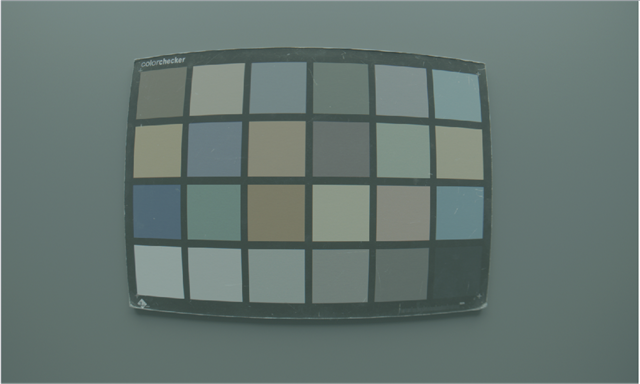

About the issue of RYYCy data, TDA4VH-Q1:Does VPAC3 support RYYCy sensor, We have made some attempts.  After performing CFA interpolation on the RYYCy data, we adjusted the white balance manually, and use CCM transformation to correct color.
Due to the limitation of TDA4 CCM within ± 1024, the correlation coefficient has been adjusted to the lowest limit. The current result is that compared to the standard color chart, the color difference of red and green color blocks are smaller, while the blue color block leans towards cyan. And the image is affected by color shading, resulting in a greenish background. The original RAW and the image after tuning are as follows.RYYCy.zip
My questions are: Do you have any suggestions about color accuracy?

    What are the sensor companding knee points and pedestal of your shared raw image?
    The "result.bmp" does not have consistent gray color and I suppose you would need to get that right before working on color.

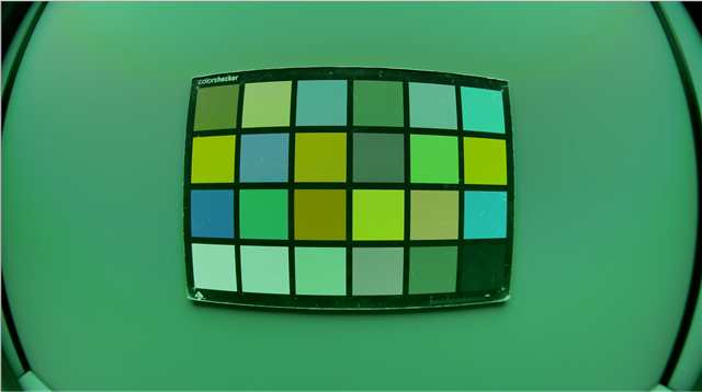

    We found that the original RAW image had more uniform colors and did not have color shading that caused inconsistent gray blocks, but the YUV image after ISP pipelining showed obvious color shading on the upper and lower edges. The original RAW is shown in the first image below, and the second image is the YUV image.
    Which module do you think is causing this problem?

  • We found that the original RAW image had more uniform colors and did not have color shading that caused inconsistent gray blocks,
    Could you please check if the knee points are correct?
    I don't see uniform gray after decompanding.
    Darker grays are more and more greenish.
    What is the sensor pedestal value we need to remove after decompanding?
    I suppose this sensor adds pedestal before companding.
