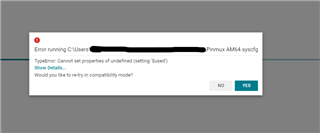

a couple of months ago I created a Sysconfig file from AM64 using Sysconfig 1.14.0 tool.
Now I updated the tool to the latest version (SysConfig 1.19.0+3426) and I'm not able to open the "Pinmux AM64.syscfg" I created before.

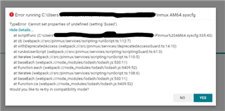

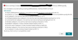

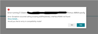

It gives me the attached error messages.
If I try to open the file with the older tool, it opens up correctly.
I would be able to edit and open the file with the new version, without recompiling all the stuff starting from scratch.
Is there a method to solve this issue?
