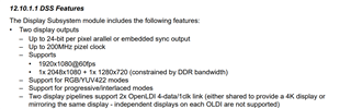

Sitara Datasheet states "..supports RGB/YUV422 video format". We would like to output instead YUV420 (20 bit bitdepth) video format, avoiding converstion. Is that any way possible? We want avoid the convertion to avoid reducing/reworking the color infromation on the video itself.

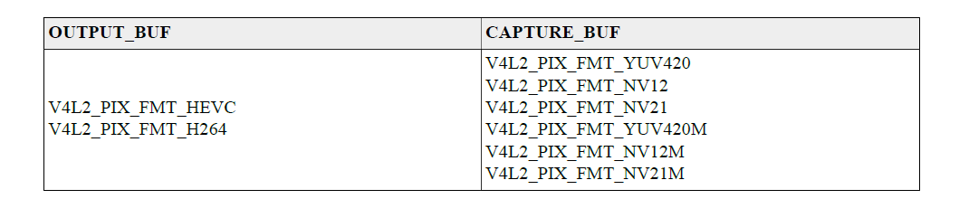

    Our Decoder on AM62A can output any of the formats mentioned below(CAPTURE_BUF) and these can be displayed using DSS

    thank you for your answer but I am a little bit confused. In the spruj16b.pdf (ti.com) doc the diagram shows 16 bit connection. Maybe I don't understand how is the inferface working, are not needed 20 bit connection for YUV420??

    I am referring to the document: spruj16b.pdf (ti.com) on Chapter 12.10  and the diagram I am referring to is in chapter 12.10.2
    There i also another table in the same chapter  Table 12-208 wher ein mention that format YUV420 is NA (at the end of the table)

    I am assuming you are referring to Table 12-408. DISPC Supported Pixel Data Formats. In the table, it's telling you we support planar format for YUV420-NV12 and packed format is not supported. I am not sure I understand the confusion and could you please clarify?

    Francesca looks for a confirmation (and base configuration reference of DSS) on how to output YUV420 data directly via parallel DSS output (VOUT signals).
    Can  the DSS be configured that way despite the TRM says:
    12.10.2.1 DSS Parallel Interface
    The DISPC Video Port 2 (VP2) outputs the required data and control signals to device pads to support the following display interface modes:
    • Parallel MIPI DPI 2.0 (Digital Pixel Interface): RGB 16/18/24-bit output with separate sync signals.
    • BT.656/BT.1120 interface: YUV422 output (8/10-bit modes) with embedded syncs.
    YUV420 is not explicitly mentioned.
    But even if limited to YUV422 for the parallel output side:
    keep in mind:
    input can be YUV420 and then DSS can convert YUV420 to YUV422.
