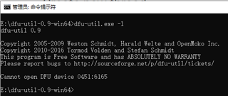

I boot am62x with dfu mode
but win10 does not recognize the dfu device,dfu-util open dfu device faild
I have to implement it on windows, is any solutions?
Lin yang
Hi Lin,
You can use Zadig - USB driver installation made easy (akeo.ie) to install the USB driver. Please refer to the following guide for the steps:
