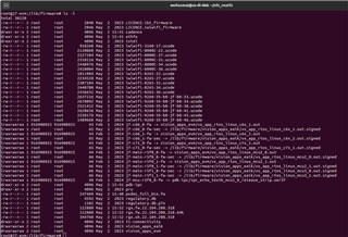

  • I did not find the firmware related to ipc_echo_test in the /lib/firmware directory
    But ipc_echo_test was specified when compiling uboot, as shown below
  • Can you do ls - l /lib/firmware/ ? and paste the screenshot ?
    Tarun
  • Hello, I hope you can continue to guide me, thank you.
