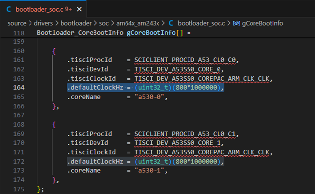

  • Hi Jim,
    The A53 cores are by default initialized with 800 MHz clock only. The default clocks are shown below
    If you are working with Speed Grade S which supports 1000 MHz then you can modify the default clock in the bootloader driver.

  • Prashant, Nick:
     Dependent on the IC speed grade, you can have A53 cores limited to 800MHz -- from sprsp56f
    I look upon my EVMs and I see the XAM6442BS... so I should be able to run at the 1GHz rate on the EVM?
    Put it another way, (from the first of Prashant's screenshots)
    if I were to change the bootloader core info .defaultClockHz parameter to 1000*1000000 , would those MCU+SDK examples run on S grade ICs ? (would there be time before the v9.2 SDK releases to prove that?)
    thanks
    Jim
  • Hi Jim,
    We have created the marketing requirement to run the A53 cores at 1000MHz. Let's see how it goes.
    For the time being, with the following changes in the bootloader driver,
    diff --git a/source/drivers/bootloader/soc/am64x_am243x/bootloader_soc.c b/source/drivers/bootloader/soc/am64x_am243x/bootloader_soc.c
    index ee9223c..ce278ac 100644
    --- a/source/drivers/bootloader/soc/am64x_am243x/bootloader_soc.c
    +++ b/source/drivers/bootloader/soc/am64x_am243x/bootloader_soc.c
    @@ -161,7 +161,7 @@ Bootloader_CoreBootInfo gCoreBootInfo[] =
             .tisciProcId    = SCICLIENT_PROCID_A53_CL0_C0,
             .tisciDevId     = TISCI_DEV_A53SS0_CORE_0,
             .tisciClockId   = TISCI_DEV_A53SS0_COREPAC_ARM_CLK_CLK,
    -        .defaultClockHz = (uint32_t)(800*1000000),
    +        .defaultClockHz = (uint32_t)(1000*1000000),
             .coreName       = "a530-0",
    the simple A53 Hello World example seems to be running without any trouble.
