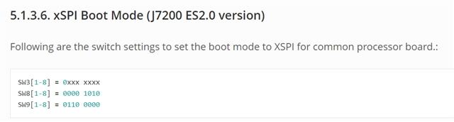

Hello! I'm looking into changing the OSPI bootmode so that the OSPI remains in 1S-1S-1S mode during the entirety of its boot process. I know this will require some changes to the source code in Uboot. I am trying to see where and what in the source code I would need to change in order for this to happen.
  • Hi Lewis,
    This is the default xSPI boot mode.
    For SR2.0 latest silicon, looking at the TRM:
    Can you try the below dip switch settings:
    SW8: 10000000
    SW9: 00110000
    I am using slightly older SDK but able to boot to U-Boot prompt using SPI mode.
