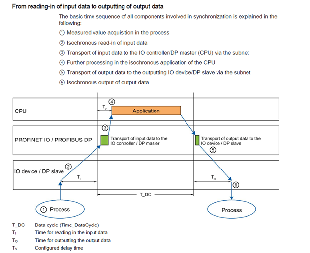

  • PRG1_IEP0_EDC_SYNC_OUT2
    The Isochronous Mode features supports two modes
    • GPIO mode - In this mode Signals will be generated on Sync1 pin at configured time.
    • Interrupt mode - In this mode, Hardware interrupt will be triggered at configured time Please note the signal will be generated in Interrupt mode also.
    What is Signal signifies?
         User can configure a maximum of two signals in a cycle. These signals can be used as Ti and To.
     What is Ti and To Signifies?
    This signal can be used to generate interrupt to input peripheral or output peripheral. That will trigger process of reading input (Ti) or writing output (To).

  • Hi Nikhil,
    The signal is used for Profinet IRT Isochronous mode. The signal / interrupt is generated at two configured time (Corresponding to Ti and To) within a cycle. This is to inform the application /stack about the time to consume a CPM and time to start copying the PPM

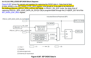

    PRG1_IEP0_EDC_LATCH_IN0
    Will get back to you on any document on this
    Depends on application - No dependency on firmware
    PRG1_IEP0_EDC_LATCH_IN1
    AM243 TRM section 6.4.13 has more details on how these latch pins can be used
