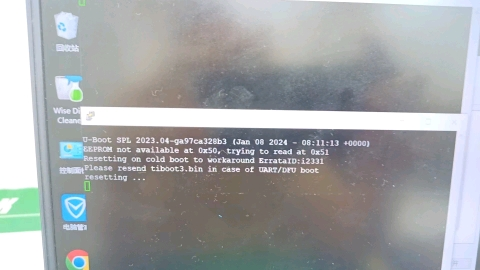

They used SD card boot, and used the below default image of SDK9.2 RT Linux SDK.
After the HW setup, when they boot this default image, they will see the below error.
U-Boot SPL 2023.04-ga97ca328b3 (Jan 08 2024 - 08:11:13 +0000)
EEPROM not available at 0x50, trying to read at 0x51
Resetting on cold boot to workaround ErrataID:i2331
Please resend tiboot3.bin in case of UART/DFU boot
resetting ...

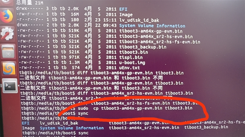

We also have tried and followed the below guide to change the gp.bin to tiboot3.bin to make it as a GP board boot.
However, this time, after this single change, there is no log in the booting anymore.

    We have double confirmed that our AM64B-SK is the HS device, so we do not need to do anything about the default tiboo3.bin. But we do not know why still face the problem here.
    resetting ...

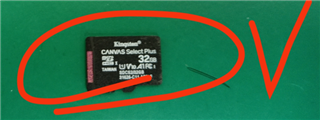

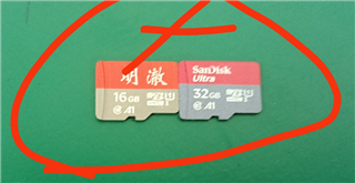

    I have tested it on my end also, we found that this is related to the SD card problem.
    We found that below SD card could work.
    The below SD cards could not work.
    I have suggested customers to install the put up 10k resistor as suggested in this guide.
