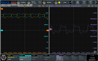

Currently, I am working on AM62xx-evm board and trying to activate LVDS CH1 (odd) port. I changed timing and resolutions for "k3-am625-sk-microtips-mf101hie-panel.dtso" in "panel-simple.c".
The display doesn't work properly. While it is working, it is flipping and half of the display works. Whole picture shrink and appears on half of the display. As you can see in the picture.

I also tried many combinaitons of the timings. This is the last one. I use LVDSchannel 1
Display timing parameters like this;
Could you help me about this?
